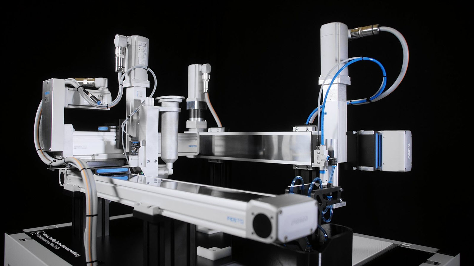

Festo introduces its newest generation of Cartesian-handling-system mechanical axes. The ELGD-TB, tooth belt actuators, and ELGD-BS, ball screw actuators, are based on an innovative Festo design.
Festo’s start-to-finish management of every aspect of the ELGD series design, testing, and manufacture ensures world-class quality, a robust and reliable supply chain for assured availability, and industry leading price/performance. ELGD axes deliver exceptional load bearing capacity and torsional rigidity, long service life, and increased reliability in multiple industrial handling situations, from dirty to cleanroom environments.
Suited to most electromechanical handling tasks, the ELGD series brings specific benefits to applications, such as:
- Cantilever systems and pick-and-place solutions for small parts handling, where short cycle times, high precision, and repeatability are key
- Handling systems for top loaders, which benefit from the ELGD’s attractive price/performance ratio, high travel speed, and long stroke lengths
- Automation of 3D printing, additive manufacturing, dosing, gluing, and picking and placing are enhanced with the ELGD’s dynamic, virtually vibration-free movement.
Smaller, more powerful axis
Festo inlaid the bearings into the aluminum extrusion and extended bearings to the full width of the axis. This design enhancement enables high loads in a compact footprint. Machine builders can pack even more powerful tooth belt or ball screw axes in smaller footprint systems to achieve excellent feed forces and acceleration profiles. The integrated bearing design also enabled Festo to develop the lower profile ELGD-WD (wide actuator) for reduced force applications. This low-profile ELGD is 30% lighter than larger units while its rigidity and guide load capacity are similar.
