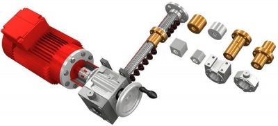

"First and foremost, it’s important to decide whether the mechanism should be rotating or translating. With a rotating unit the spindle stays in a fixed position and rotates, causing the load-carrying nut to move up or down. A translating unit is the opposite of this as the nut stays still and the spindle moves through it. Often the nature of the application dictates which mechanism is required; though when designing-in a translating unit, space must be allowed to accommodate the spindle in both its extreme positions," Carr said.
The decision between a trapezoidal or ball screw and a worm gear or bevel gear is not quite so ‘open and shut’. Much of the decision comes down to individual requirements in terms of load and speed requirements, as well as the expected duty of the application once installed. A good supplier should be able to offer guidance and explain how the different combinations may complement the requirement of your application in different ways, helping you to source the most efficient solution.
As with any equipment involved with the movement of potentially heavy loads, safety must be considered from the outset. Buckling is a very real hazard if a screw jack has not been properly specified; the mechanics of buckling are related to the material, length and diameter of the spindle, as well as the load it’s carrying. For guidance, manufacturers use a system called the Euler Number which helps engineers to work out minimum safety figures.
A further safety consideration is that some screw jacks are self-sustaining - meaning they can hold position without a brake – while others are not. It’s important to understand this when specifying a jack. Trapezoidal spindles are normally self-sustaining but vibration and shock loads may compromise this ability. Ballscrew spindles are not self-sustaining and must be braked if used vertically. As with all safety issues, it is probably best to seek expert advice.
"A final comment needs to be made on sizing and selecting a drive motor for a screw jack. Each project is unique and deserves individual attention to be paid to the motor selection. Usually a standard induction motor is used, but there may be occasions when a servo or other motor type is a better option. The formulae for motor selection are generally simple, and these should be calculated using the dynamic load rather than the static load. The screw jack supplier should be happy to help – and they should always recommend a slight oversizing of the motor to account for unexpected friction, misalignments, increased load, shock loads, and adverse operating conditions," Carr added.
