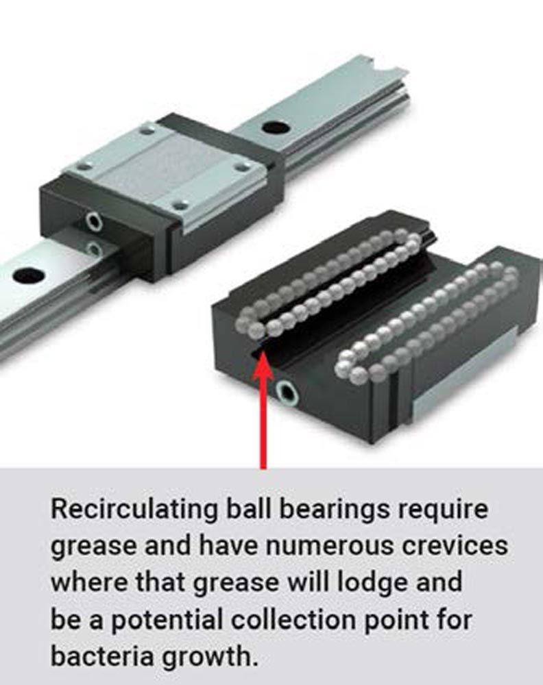

For linear recirculating ball bearings, use only stainless steel–sealed bearings with compliant seal materials and approved lubrication. There are two basic types of plain bearings. When using plastic inserts, be aware of moisture absorption that will lead to the bearing material swelling. This can result in binding issues. If the inside diameter is increased to deal with swelling, this often causes loose tolerances and inaccuracies in the system.

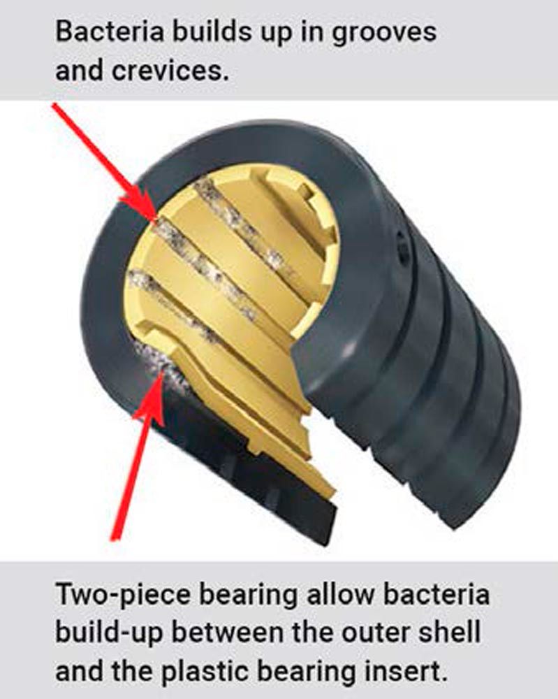

It is best to avoid open-ended bearings with grooves or inserts in areas that may be susceptible to bacteria buildup. These two-piece bearings will allow microscopic bacteria to seat in crevices, grooves, and between the outer shell of the bearing and the plastic bearing insert. One-piece bonded bearings eliminate this potential for bacteria collection.
Figure 2—Recirculating ball bearings require grease and have numerous crevices where that grease will lodge and be a potential collection point for bacterial growth.
If they are to be used in a food-grade environment, ensure that materials and fillers are compliant with applicable standards.
The same design principles apply to recirculating ball bearing products, such as roundway linear ball bearings and profile rails. They provide advantages such as low friction and tight tolerances and are often available in stainless steel materials with FDA-compliant lubrication. However, they can present disadvantages in that they require grease lubrication to be used due to metal-to-metal contact. This lubrication picks up material from food items being processed, which can become trapped inside the multiple crevices and cavities around the balls and in the raceways of the bearing. This can potentially be a breeding ground for unwanted bacteria.

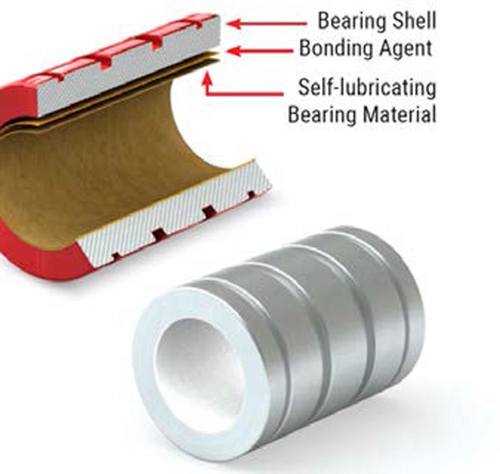

Figure 3—One-piece bonded bearings are the best solution for most washdown applications.
The best solution for most applications is a one-piece bonded bearing that uses PTFE-based, self-lubricating bearing materials that require no external lubrication. In addition, there are no grooves, crevices, or spaces between the liner and bearing shell where residue can become lodged, allowing bacteria to grow. The bearing material and outer shell are bonded together, creating a true one-piece bearing.

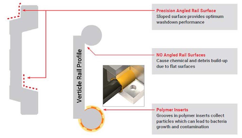

Rail Design and Selection
Figure 5—The sloped surfaces of precision-angled rails offer improved washdown performance by eliminating areas where particles can collect, leading to bacteria growth and contamination.
It is best to avoid as much component assembly as possible in a washdown environment. Traditional linear assemblies utilize a shaft and support rail bolted together, which are then bolted to a mounting plate or carriage. Each of these connection points creates a joint, crack, or crevice and a potential location where liquids can penetrate or where bacteria can begin to cling and build up over time.
New technology in linear motion has created slide assemblies that eliminate the need for multiple components and connectors. Unique two-piece slide systems are an ideal solution for washdown environments. In addition, these components have smoothly curved edges, without recesses where buildup can occur.

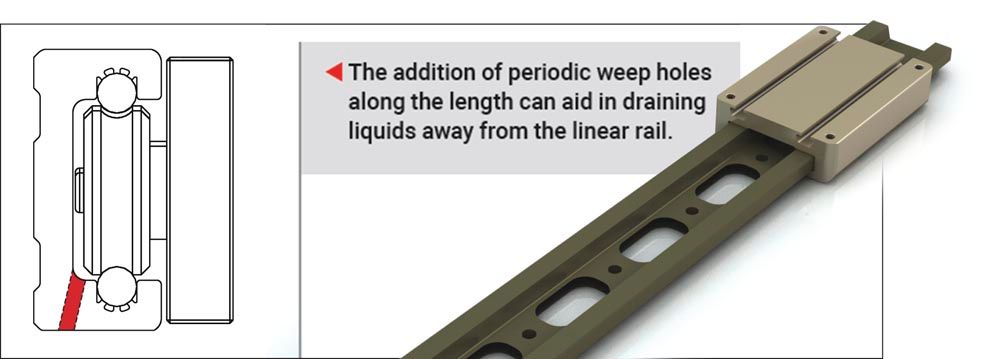

Another tactic used to manage moisture and fluids around linear motion components is to add weep holes, drainage channels, slots, or other porting features designed to channel moisture away from potential pooling areas.
The example below shows a long rail that often is mounted flat in a washdown environment. Liquids can naturally collect and pool along the length of the rail. By adding slots at strategic points along the rail, these collection areas can be easily eliminated. When combined with standoffs, this type of rail feature creates a linear guide system that is fully exposed and can be sanitized completely.
Figure 9—The addition of periodic weep holes can aid in draining liquids away from a linear rail.
