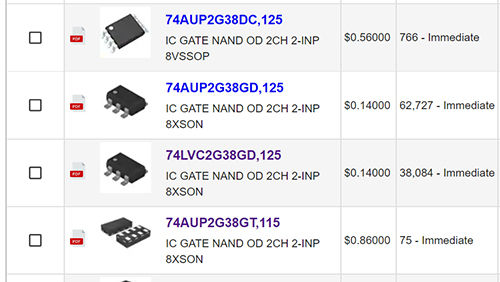

Figure 3.5 shows differences in availability even from same manufacturer for the same basic part number. The middle two choices seem to have a lot more flow. You should check multiple distributors. Talking with a company rep may also gain insight.

  • 3.5 Verify footprints for all parts — sufficient for soldering, correct board density
    • 3.5.1 For parts available with multiple footprints, are we using the most commonly available variety? Are alternate sources actually available in that footprint?

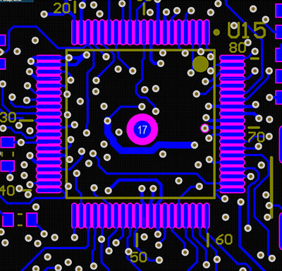

  • 3.6 Do all footprints have a clear Pin 1 marker
  • Dot to upper right is pin 1. - This also shows a fiducial (middle marked with 17), and numbering of pins around the IC to help with troubleshooting and debugging.

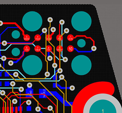

  • 3.16 Are Programming pads available w/o disassembly (if possible)?
  • Pads for emulator tap are laid out on both top and bottom of board to make the connection accessible from either side of the processor board.

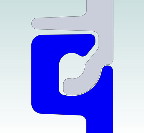

This is two extrusion halves. The signal from the inside of the box (Right) does not have a direct path to exit the box. The long and thin clearance blocks all frequencies likely to be encountered, having a cutoff frequency much above the requirements (blocking all lower frequencies with a very high attenuation). A screw goes into the center hole to hold the two pieces together and to push the edges in contact. The clearance without the screw in place makes assembly easy.

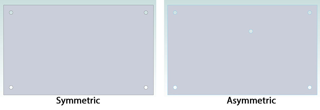

  • 4.5 Try to make mounting holes on PCB asymmetrical. This helps avoid strong vibration modes of the board. Nice symmetrical mounting holes make for strong vibrations when the wrong vibration frequency is found. An added screw off center can significantly spoil the “Q” of the vibration modes of the board. Think of a thumb on off center on a snare drum!

A quick search of “vibrational modes of a rectangular membrane” will provide animations of the vibration modes. These require symmetry to allow the energy to easily propagate from one region to another. Break the symmetry, and the modes become much fewer and less effective.

  • 5.2 Try to design overlaps to form “waveguide in cutoff” for joints to keep electrical noise from making it through a gap — either in or out of electronics.
