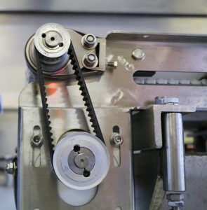

After discovering Custom Machine and Tool Co., Inc. (CMT) on the Internet, Vande Berg Scales recognized the advantages of CMT’s Concentric Maxi Torque line of products. Custom Machine and Tool Co., Inc. had designed and patented a more reliable connection format, the Concentric Maxi Torque bushing system, which offers zero backlash and high clamping torques.  These features, unique to the industry, would prove to enhance and strengthen VBS’ product line.  Along with its low profile design, the benefits allowed for direct coupling to the motor shaft, reduced costs by dismissing the need for a custom length shaft and eliminating a bellows coupler on the motor.
Comparison of the Concentric Maxi Torque against other connection systems.
With its ease of positioning and the fact that it virtually defeats shaft damage due to its mechanical shrink fit, this connection system is the perfect fit for in-motion weighing systems.  The Concentric Maxi Torque System was integrated so as to satisfy these precise pulley requirements.
How the Concentric Maxi Torque System Works
Pulley and bushing are sold together as an assembly.  There is a mechanical shrink fit affected by using a setscrew, axial to the shaft, as a lever to force the tapered bushing into the matching taper in the hub. As the lever forces the two tapers together, the slot in the bushing is compressed, thus clamping the pulley to the shaft with a mechanical shrink fit.  That same set screw is removed and used on the opposite hole, which acts as a jack, releasing the shrink fit and allowing for removal or re-positioning.
“It is a fantastic and very innovative product that makes complete sense for our needs,” said David Vande Berg of VBS. “The Concentric Maxi Torque’s smooth running power is key to the in-motion weighing system’s performance.  Finding or building these attributes into components can be time-consuming, expensive, and difficult to repeatedly achieve.  By implementing the Concentric Maxi Torque, it allows us to focus our resources on other areas to gain further improvements in our product offerings.”
Vande Berg added, “The increased benefit in performance with the Concentric Maxi Torque design enables us to fabricate the components we need without long searches and outsourcing.  With CMT’s product, resources can be diverted to improve other areas of our designs while achieving a reduction in needed machining time.  The keyless hub-to-shaft connection device has superior features and benefits compared to other connection systems such as keyways, pins, set screws, clamp collars, and other tapered shaft locking devices.”
Image showing the Concentric Maxi Torque assembly.

Image of the Concentric Maxi Torque in Vande Berg Scales' In-Motion Checkweigher.
