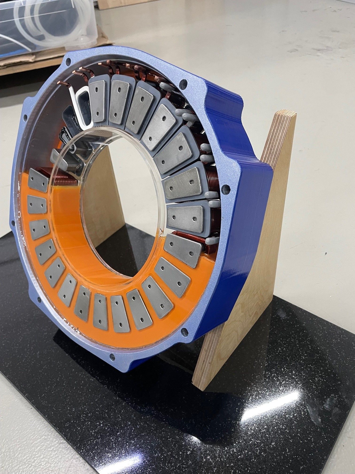

Lambda Resins offers a highly practical solution. Through targeted material development, the company has created a thermally conductive resin system so structurally robust that it can eliminate the need for bonding processes entirely. Instead of maintaining dozens of hot-press stations for bonded joints, Lambda Resins enables the direct casting of entire functional units – faster, more reliably, and with drastically lower capital investment. This doesn’t just make axial flux motors technically attractive – it makes them economically feasible.
Lambda Resins' technology radically simplifies axial flux motor assembly. Instead of bonding, fixing, and thermally treating individual teeth, the innovative resin system enables the direct casting of complete functional units – including coils, tooth structures, and insulation.

A further technical benefit: the resins’ thermal expansion behavior is finely tuned to match the metal components used. Traditional weak points such as cracks and delamination are effectively avoided – even under the extreme lateral and torsional forces generated by high-frequency magnetic fields.
The encapsulation process also unlocks new design freedoms. By eliminating adhesives, mounting plates, and insulation layers, many components can be left out altogether – including intricate busbar holders and expensive GFRP or CFRP covers, which are prone to failure under vibration stress. Their removal allows the air gap between coil and magnet to be reduced by more than 60 percent – directly boosting efficiency through more torque, greater output, or lower energy consumption at equivalent performance.
