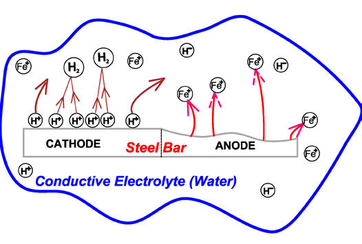

Figure 1—Microscopic view of a corrosion cell on a steel bar, illustrating how differing electrical potentials create an anode where iron ions are released and a cathode where hydrogen gas forms, initiating the rusting process.
To understand wet corrosion and the problems it can create, Figure 1 shows a microscopic view of what happens in a typical corrosion cell. This shows the corrosion of a steel bar, and because of minute differences in the electrical potentials within the bar, the anode area is being attacked while the cathode area is protected. At the anode, Fe+ (iron) ions are released. (An ion is an atom with an electrical charge.) They are off in the liquid, usually water, and will eventually pair up with some oxygen ions to form the various forms of rust that we see all around us.
This article appeared in the June 2025 issue.
Only a very short distance along the bar is the cathode, where the hydrogen ions, from the water H2O molecules, are being liberated. As shown in the diagram, most of those ions rapidly find another ion and form hydrogen gas. However, there is always dissociation and some of those hydrogen ions wander off to do later damage.

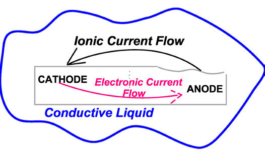

Figure 2—Corrosion circuit in a steel bar, showing electron flow through the metal and ionic current through a surrounding liquid, highlighting the necessity of moisture for corrosion to occur.
Going back to that steel bar, as shown in Figure 2, the internal electric charges flow from the cathode to the anode, and then, to complete the corrosion circuit, the ionic currents flow back through the liquid. From this figure we can see that there has to be liquid present to conduct the currents that result in the corrosion.
Unfortunately, that doesn’t mean the part has to be dripping in water, and we’ve all had cases where a relatively clean piece of steel has emerged from a long seclusion in desk drawer with a light coating of rust. It turns out that, due to intermolecular forces, corrosion can begin at only 60 percent relative humidity.
It’s also interesting that, the more conductive the liquid, up to a point, the more rapid the corrosion. That’s because a more conductive liquid, such as salt water, can more effectively carry the corrosion currents.

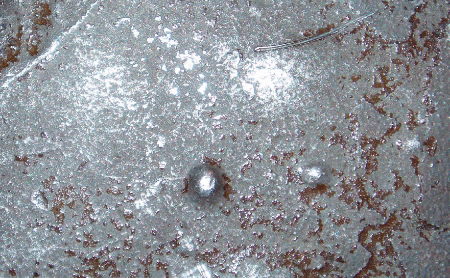

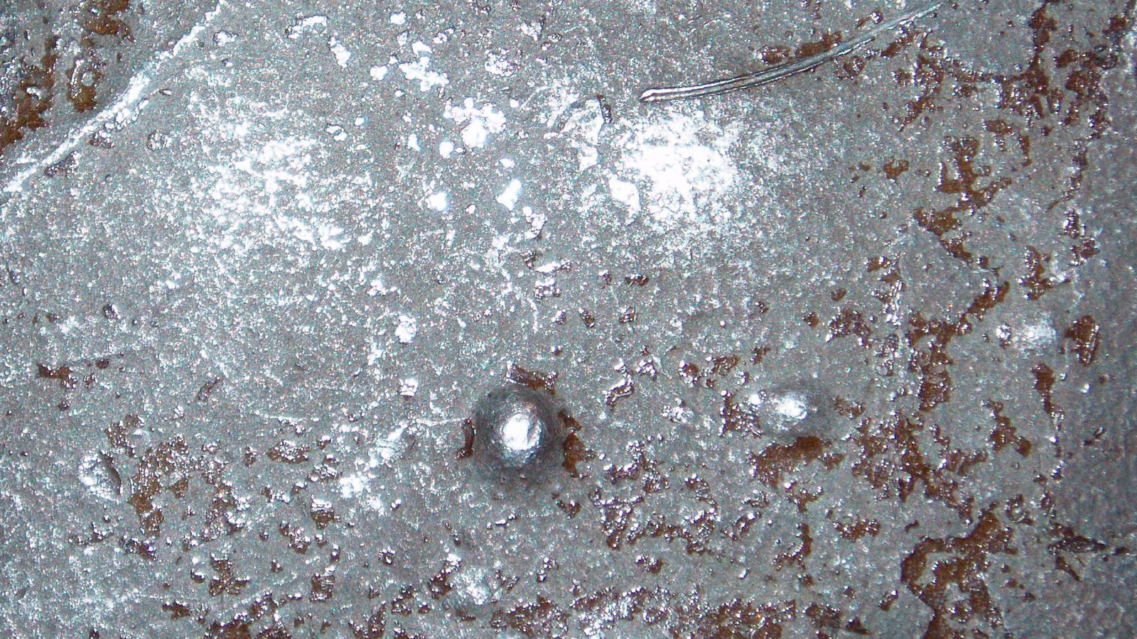

With ductile metals, such as low carbon steel, the material can easily deform and the reduction in strength isn’t terribly significant. Figure 3 shows a piece of SAE 1020 steel with a series of blisters that are about a quarter inch in diameter and are filled with hydrogen. It was part of some chemical process equipment and wasn’t highly stressed so the blisters didn’t cause any problems, but larger blisters can cause reduced ductility.
Figure 3—Surface blisters on SAE 1020 steel caused by trapped hydrogen—common in ductile metals and typically harmless under low stress, though larger blisters can reduce material ductility.

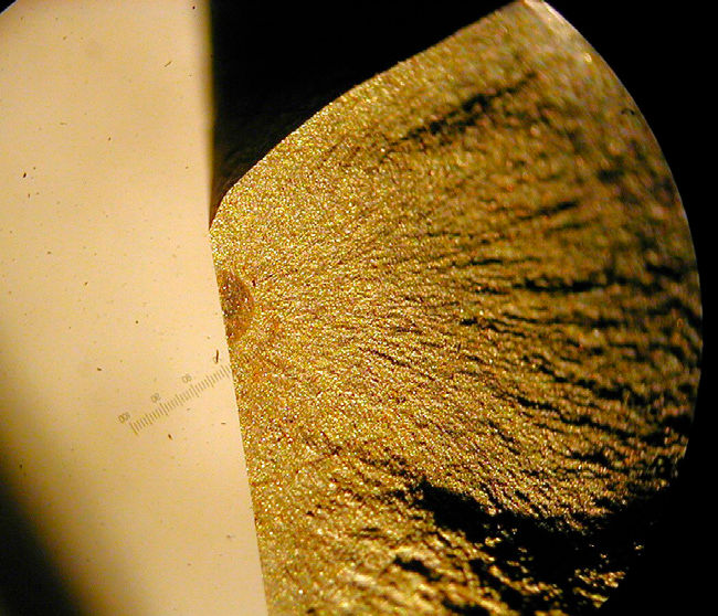

However, as steel is processed to become stronger, it almost always becomes less ductile and the effect of the atomic hydrogen becomes more critical. Figure 4 shows the magnified fracture of a steel spring used in a piece of pharmaceutical equipment. The bottom of this HRC 50 spring was rusted, the result of the cleaning process and a poor machine design. Looking at the crack face, the corrosion at the origin is readily visible, and a metallurgical analysis confirms that hydrogen was involved.
Figure 4—Magnified fracture of a high-strength steel spring (HRC 50), showing corrosion-induced cracking from hydrogen embrittlement—originating at a rusted area caused by cleaning and poor design.
