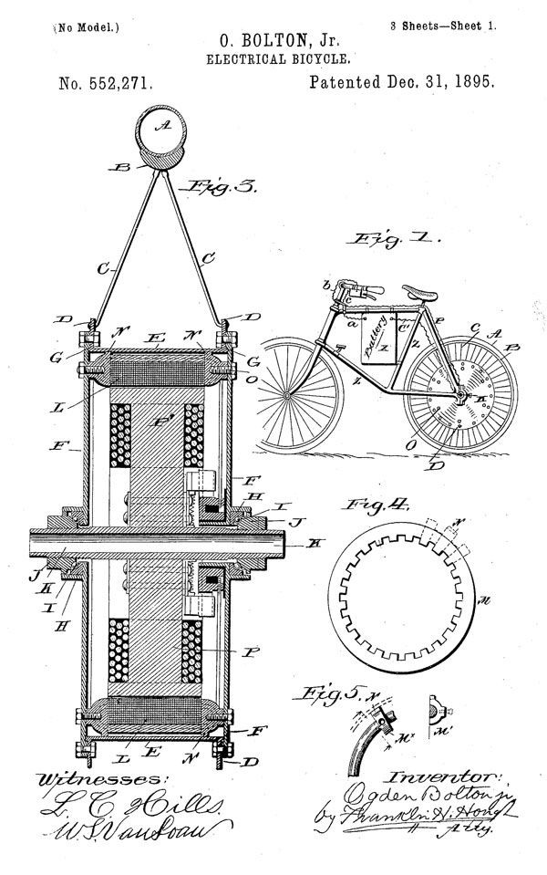

labriola1.jpgThe first electric bicycles used  a transverse flux motor, among the earliest forms of hybrid motors (U.S. Patent No. 552,271, from 1895).
The vast majority of hybrid motors are used as open-loop step motors. The simplest and lowest cost and also lowest performance versions are the 6-wire motors driven from a power source to the center tap of each winding with four transistors to drive each winding half to the ground. Adding a series resistor to the center tap increases the ability to make the current change more quickly and allows the motor to operate from a higher voltage, improving the power at higher speeds, but the constant current through the resistor also generates significant heat. Also, the typical six-wire configurations are using only 50% of the copper at any one time. Bipolar motors—typically four-wire configurations—use all the copper in the motor, which reduces the resistance of the motor with the same windings by 50%, allowing 1.41 times the current rating for the same number of turns and gauge of wire. The higher current increases the available torque of the motor with bipolar windings. The Bipolar motors use more transistors, but the additional transistors also improve the ability to both drive current into the winding and to pull current back out of the winding in a controlled manner, useful when decelerating the motor.

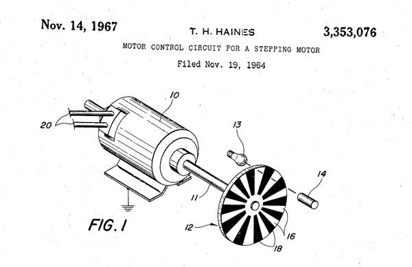

labriola2.jpgAmong the earliest closed-loop steppers was this encoder-controlled motor (U.S. Patent No. 3,353,076, from 1967).
This article appeared in the August 2022 issue.
Closed Loop Stepper:
As stated earlier, the original application for hybrid (transverse flux) motors used brushes to commutate the motor to keep the torque angle of the motor at an optimal angle. The first closed-loop step motor designs emulated this operation while going brushless by adding encoders with 200 counts per revolution, corresponding to 200 full steps in a common 1.8-degree step motor. The “closed-loop stepper” uses a step generation circuit that limits the step rate to prevent the step drive angle from getting more than 1 or 1.5 full steps (according to the patent) ahead of or behind the measured rotor position. This operation prevents the motor from losing synchronization and improves available torque when accelerating or decelerating.

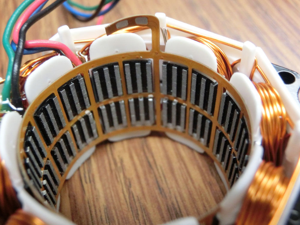

labriola3.jpgThe Mosolver from Quicksilver Controls is an exampole of a full hybrid servo motor.
Hybrid servo motors have a much higher pole count—typically 50 (1.8 degree) or 100 pairs (0.9 degree). The design of the hybrid servo allows rotor magnets to be shared with many poles, enabling the high pole count while still having a simple design. The stator windings have a small end winding factor, so most of the copper is torque producing. The resulting structure results in a remarkably high motor quality factor (torque per square-root of power), allowing for high continuous torque. The trade-off is a lower top speed capability. This low speed limitation is often offset by not needing gearheads or in other cases as many stages of speed reduction for a given application.
