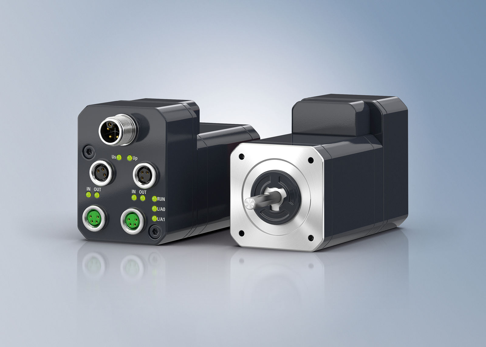

The ASI8100 series covers all motion requirements for stepper motors in the power range up to 250 W. Easy-to-read status LEDs report drive conditions. With the integrated travel path control, simple function blocks for motion applications are built in. The standardized connectors – M8 for EtherCAT and M12 for power – minimize assembly time, cost, and complexity. The two additional I/Os enable effective execution of drive-related functions, such as the detection of end positions or latching.
The stepper series starts with NEMA 17 drives (42 mm), available in two stack lengths with a 0.29 Nm or 0.8 Nm holding torque. Four additional NEMA 23 devices (56 mm) offer holding torques of 0.75 Nm, 1.4 Nm, 2.35 Nm, and 2.5 Nm. Pre-assembled cables and infrastructure components, such as IP67 distribution box modules, are available as accessories.
