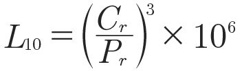

The inner and outer rings of a radial ball bearing are constantly loaded during rotation. This produces material fatigue which eventually leads to bearing failure. The bearing life of individual bearings can vary considerably, even if they are of the same size, same material, and subject to the same operating conditions. For a statistically large group of identical bearings operating under the same conditions, basic rating life is the number of revolutions reached by 90 percent of the group of bearings prior to the first evidence of material fatigue. The basic rating life can also be expressed in hours. Examples of typical design life requirements for common operating conditions are shown in Table 1.
Both the ABMA and ISO standards use the same method to determine the basic rating life of a bearing. When the bearing experiences combined loading (both radial and axial loads) the standards provide a method to determine the equivalent radial load (Pr).The equation for the basic rating life of a dynamically loaded ball bearing is as follows:
and
Where:
L10 = Basic Rating Life [revolutions]
Cr = Basic Dynamic Load Rating [N]
Pr = Equivalent Radial Load [N]
L10,h = Basic Rating Life [hours]
n = Operating Speed [rpm]
The basic rating life formula is acceptable for general use and correlates with 90 percent reliability, common material and manufacturing quality, and conventional operating conditions. However, for many applications where a reliability greater than 90 percent is required, and/or where there are special bearing properties or a deviation from conventional operating conditions, an adjusted rating life formula is used:
