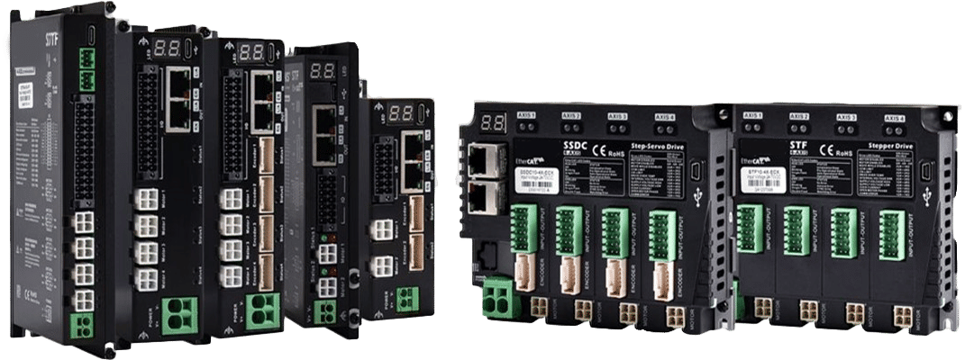

The Applied Motion Products STF Stepper Drives and SSDC StepSERVO Drives are now UL Certified by Underwriters Laboratories. The drives now meet stringent safety standards with certification, reducing risks of electrical hazards, fire, or component failures. The STF Stepper Drives are DC-powered microstepping drives that control two-phase, bipolar step motors. They feature advanced current control and an anti-resonance algorithm that electronically dampens motor and system resonances, enhancing motor smoothness and usable torque across a wide speed range. Additionally, the drive incorporates electronic torque ripple smoothing and microstep emulation, significantly reducing motor noise and vibration for optimal performance.
The SSDC StepSERVO Drives are closed-loop versions of our proven, high-performance microstepping step motor drives. By integrating closed-loop servo control algorithms and pairing them with StepSERVO Motors equipped with high-resolution encoders, these drives enable StepSERVO systems that outperform traditional step motor solutions. Benefits include up to 50% higher peak torque, smoother and quieter operation, and reduced power consumption, delivering superior efficiency and performance.
