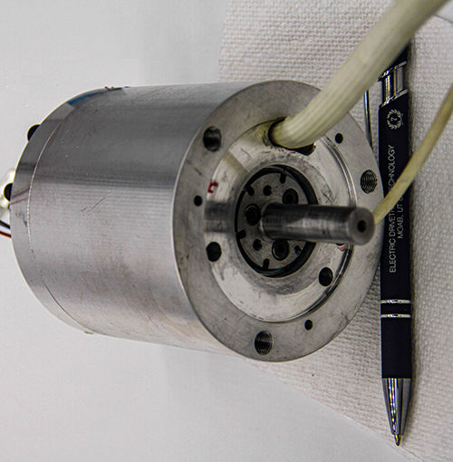

4 Nm VSR => A 75mm diameter Switched Reluctance Motor that will deliver 8 Nm peak torque.

The (variable) switched reluctance (VSR) motor has also been investigated as a potential solution to the magnet crisis, and we have seen many more VSR designs enter the marketplace. Unfortunately, the VSR motor requires very specialized controllers along with some operating noise, which offsets some of the potential cost savings that they offer. Yet, we can build VSR motors in the 1 KW range that operate at > 95% efficiency, which compares favorably with similar PM motors. Thus, in the correct application, the VSR motor can be an attractive motor alternative to a PM design.
