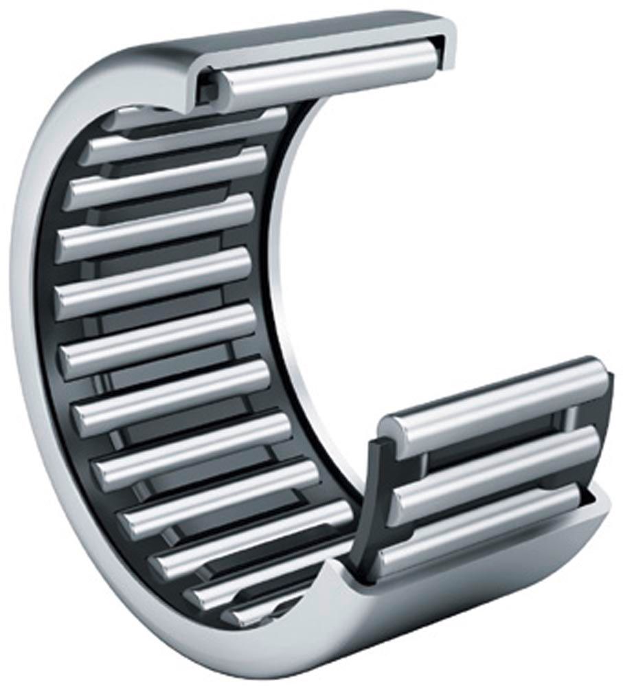

Needle rollers can be used in several different assemblies for different applications, including loose rollers, rollers, and cage assemblies, drawn cup, and machined products. How the bearing will be housed in an application will dictate whether a drawn cup, machined, or cage and roller assembly is needed.
Schaeffler developed -D- types that use longer needles within the same total bearing diameter; this increases load capacity and allows for load increases without design changes. Alternatively, you can achieve the same load with less space.
The D-XL series boasts an improved cage design that allows a higher number of needle rollers with higher load-carrying capacity, less friction and weight as well as reduced operating costs. D-XL bearings are part of Schaeffler’s X-life lineup of premium bearings, which optimizes the contact outer raceway’s contact surface for less friction, especially with plastic cages, and longer operating life.

Automatic transmissions, which often have several NRB positions, use the cage and roller assemblies, thrust bearings, drawn cup and machined-type NRBs.
In the planetary train, cage and roller assemblies are used for the planets with the inner raceway directly on the planet pin, while the outer raceway functions as the planet pinion’s bore, where it supports high rotational speeds and centrifugal forces.
In addition, Schaeffler offers KZK- and KBK-type NRBs specifically for crank and piston pins.
Needle roller and cage assemblies for connecting rod bearing arrangements are used in the crank mechanisms of two- and four-stroke engines as well as in compressors for supporting crank pins and piston pins. Consisting of cages equipped with needle rollers, they support high centrifugal and acceleration forces and are suitable for high speeds.
They require very little radial space since the radial section height only corresponds to the diameter of the needle rollers. They give bearing arrangements high runout accuracy which is, however, influenced by the geometrical accuracy of the raceways. The radial internal clearance is dependent on the needle sort as well as the shaft and housing tolerances and can be adjusted by means of the needle roller sort.
Needle roller and cage assemblies for crank pins (i.e., KZK NRBs) are externally guided, which means that the connecting rod bore guides the cage radially with defined clearance. The radial movement of the cage in relation to the connecting rod bore and the rolling elements is as small as possible.
The cages are made from quenched and tempered steel, have good wear resistance, exhibit high strength and their large guidance surfaces are designed for optimum lubrication.
Needle roller and cage assemblies for piston pins (i.e., KBK NRBs) are internally guided, which means that the piston pin guides the cage radially with defined clearance. Due to their small radial internal clearance, tilting of the connecting rod is reduced to a minimum. The needle roller and cage assemblies support high frequency oscillating loads and are available for most piston pin diameters in various widths, in accordance with the piston boss spacing. The steel cages are case hardened or quenched and tempered, exhibit good wear resistance, and have high strength.
