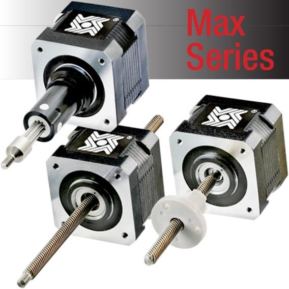

Based on the company’s compact hybrid 43000 motor, the Max Series Size 17 delivers up to a 30% performance enhancement over its predecessor when used with almost all available lead screw options. Available in captive, non-captive, and external linear designs, the upgraded single- and double-stack actuators offer:
•Resolutions from 0.00006 inch (0.001524 millimeter) per step to 0.00192 inch (0.048768 millimeter) per step
•Thrust of up to 50 pounds (222 N) for single-stack and 75 pounds (337 N) for double-stack
•Speeds exceeding 3 inches (7.62 centimeters) per second for single-stack and 7 inches (17.8 centimeters) per second for double-stack
The Size 17 hybrid actuator is the first in the Max Series, with additional sizes planned for future release.
