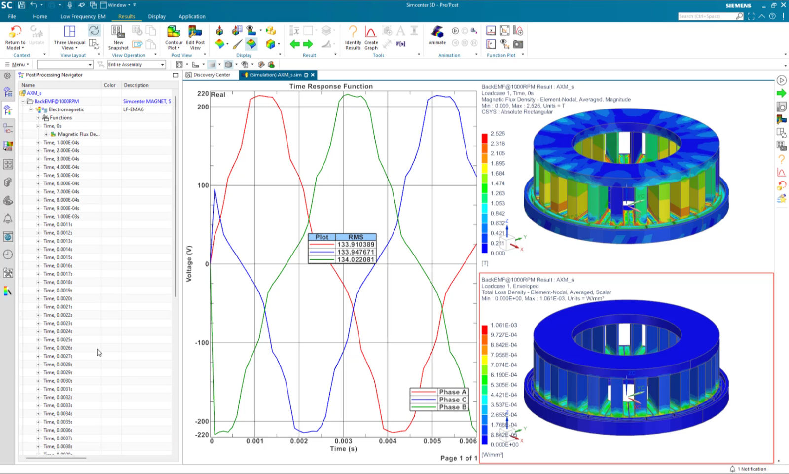

Simcenter enables design and simulation of axial flux motors in a single workflow
Simcenter enables design and simulation of axial flux motors in a single workflow.
Simcenter enables faster design and simulation of compact, high-power-density motors with axial flux motor simulation. Engineers can quickly create lightweight designs using Siemens’ Simcenter E-Machine Design software, then transition seamlessly to 3D simulations in Siemens’ Simcenter 3D software for comprehensive electromagnetic, thermal and mechanical performance assessments.
In turn, the latest software update introduces gear design optimization where engineers can utilize lightweight gear blank parameterization and an optimization framework to improve gearbox noise, vibration and harshness (NVH) performance. These tools help reduce late-stage design changes and streamline the development cycle.
