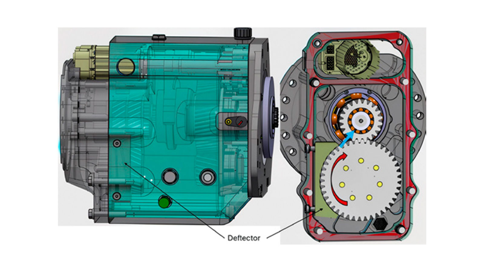

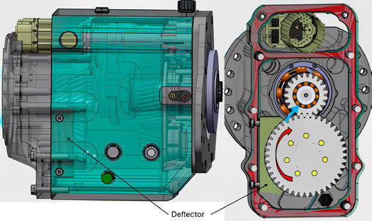

Figure 1—Two-speed gearbox isometric and cutaway views showing the deflector.
Figure 1—Two-speed gearbox isometric and cutaway views showingthe deflector.
During the development process, the manufacturer identified a critical region that could lead to an overheating bearing problem. Figure 2 shows a cut view centered on the narrow gap between the second gear and the input gear. Anticipating this problem, the manufacturer added a deflector to their design. The goal was to guide more lubricant toward the narrow gap to induce better cooling of the bearing. They built a test bench and faced the anticipated problem.
Despite the deflector, they observed some damage on the input gear bearing. Paint labels were placed on the neighboring gears and indicated high temperatures confirming the overheating problem. To expedite the iteration process and identify a viable solution, the client sought our assistance to develop a comprehensive analysis workflow that could replicate the problem and test potential solutions efficiently.
Our first objective was to reproduce the problem, by simulating the exact same configuration as the one on their test bench. Once correlated, we could investigate the results, understand the lubricant behavior and test several concepts to solve the overheating problem. This case presented an excellent opportunity to demonstrate the capabilities of advanced simulation techniques in addressing real-world engineering problems, ultimately contributing to the company’s success in developing reliable and efficient products.

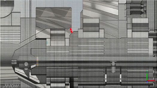

Figure 2—Cutaway view of the gearbox, zoomed on the narrow gap region.

The minimum lattice dimension is determined based on the narrowest region where the lubricant flow needs to be captured. A visual of the lattice used in the analyses is shown in Figure 3. To ensure an accurate velocity gradient, at least three to five lattice volumes should be present in the narrowest region, indicated by the red arrow. Local refinement regions must be defined carefully to fully encapsulate the entire rotating body; otherwise, the solid-fluid interface will not be modeled accurately.

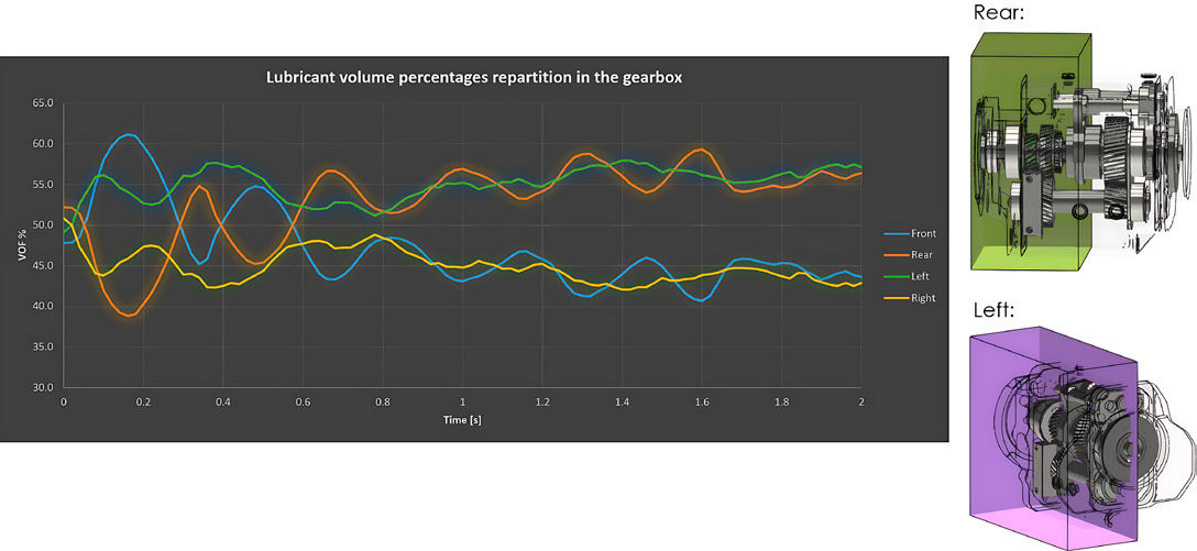

While the analysis is running, the user can monitor scalar variables through graphs. To determine if the flow is fully developed, key values such as torque on rotating parts and lubricant volume within specific regions should be observed. These variables should stabilize and tend towards a fixed value to confirm that the flow has reached a steady state. Due to the highly turbulent nature of the splashing, some oscillations may appear and must be interpreted carefully. However, there should be no significant variations or trends indicating an increase or decrease. Figure 4 illustrates the distribution of the lubricant in different volumes of the gearbox. After 2 seconds, around 56 percent of the lubricant is inside the rear half, and 57 percent is in the half left.
On the graph, a transient phase is evident during the first second with important oscillations, before the flow begins to stabilize.
Once the flow is confirmed to be fully developed, the first post-processing phase begins. At this stage, a wealth of information can be extracted prior to the heat transfer analysis. Qualitative insights are derived from the generated animations, which offer valuable visuals inside the gearbox, revealing details that would otherwise be impossible to observe. In Figure 5, the left image shows a global cut view of the gearbox with a colored representation of the lubricant velocity. The right image shows a cut view in another direction, allowing for visualization of the lubricant movement close to the overheating bearing. These visuals serve as a first qualitative indicator to evaluate the lubrication efficiency.

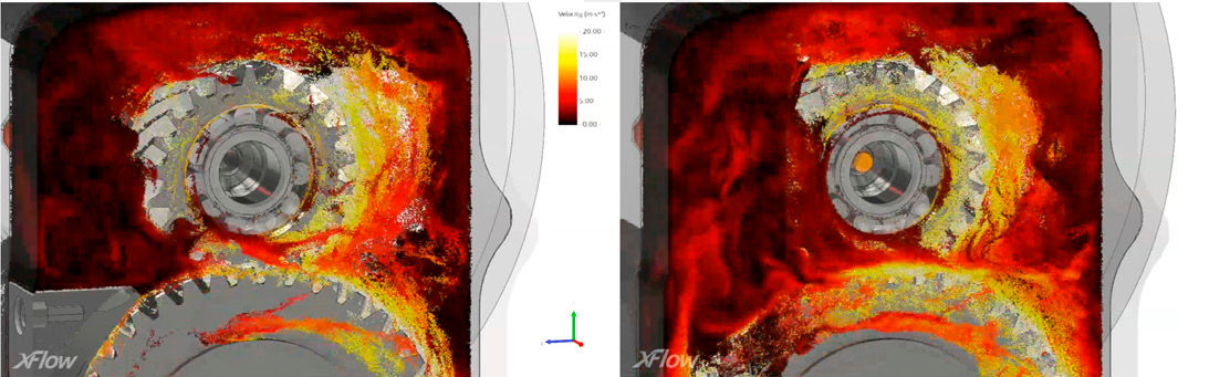

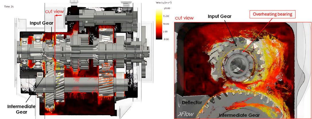

Visualizing the flow velocity, dark areas are noticed above the deflector. It seemed that the flow was obstructed by the deflector, and very little was directed towards the overheating bearing. We tried removing the deflector.
Figures 6 and 7 present a comparison of the lubricant movement with (left) and without (right) the deflector.
The red bent arrow tells the rotation direction of the intermediate gear. In the left image, the darker areas above the deflector and next to the gearbox floor indicate lower lubricant velocity, which could indicate some recirculation pockets inducing inefficient cooling. In the right image, without the deflector, the lubricant velocities are higher, suggesting that the lubrication should be more efficient. Without the deflector, the lubricant flows faster closer to the gearbox floor, moves up faster against the left wall and more lubricant seems to come in contact with the overheating bearing.

Figure 6—Comparison of the lubricant motion with (left) and without (right) the deflector, showing more movement without the deflector.
Figure 7—Comparison of the lubricant motion with and without the deflector, zoomed in on the overheating bearing, showing better lubrication without the deflector.
A zoomed-in image in Figure 7 confirms that more lubricant appears to reach the overheating bearing without the deflector. Without the deflector, in the right image, more colored particles are seen in front and around the overheating bearing. Another visual tool can be used to evaluate the cooling efficiency, using the wet areas. They can be displayed by projecting the flow onto solid surfaces. Because the flow is very turbulent, these visuals are challenging to obtain precise information from.

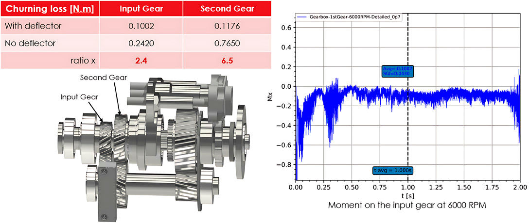

Churning losses of all rotating parts provide measurable values to track and compare. Figure 8 reveals a table comparing the measured churning losses on the input and second gear, with and without the deflector. The graph on the right shows the evolution of the churning loss (moment, Mx) with time. After the transition phase that lasts for about 0.5 seconds, the value stabilizes, and an average is computed.
Figure 8—Churning loss estimation of gears showing more important churning losses without the deflector.

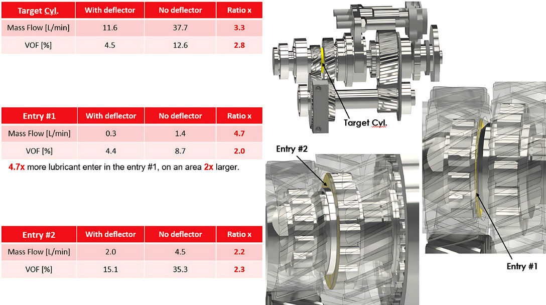

Figure 9—Surface integrals measuring the amount of lubricant in specific areas, indicating that more lubricant enters the narrow region without the deflector.
Figure 9—Surface integrals measuring the amount of lubricant in specific areas, indicating that more lubricant enters the narrow region withoutthe deflector.
Churning loss refers to the resistance created by lubricant splashing on a rotating part. Higher churning loss indicates greater lubricant activity. We observed that the churning losses on the input gear are 2.4 times higher without a deflector, and 6.5 times higher on the second gear.
Creating surfaces for post-processing allows the integration of the quantity of lubricant passing through them with time, enabling comparison of the amount reaching specific areas of concern. The distribution of lubricant on these surfaces can also be measured in terms of VOF percentage (volume of fluid). A higher VOF percentage indicates that the lubricant covers a greater area of the surface. In Figure 9, the tables present the quantity of lubricant crossing several surfaces, allowing for comparison with and without a deflector. The Target Cyl refers to the narrow gap between the input gear and the second gear. The Entry #1 refers to the access to the overheating bearing, below the input gear. Entry #2 identifies the access to the roller bearing below the second gear.
Both mass flow and VOF distribution show higher values without the deflector. Through Entry #1, which leads to the overheating bearing, 4.7 times more lubricant flows, indicating that the cooling could be more efficient without the deflector.

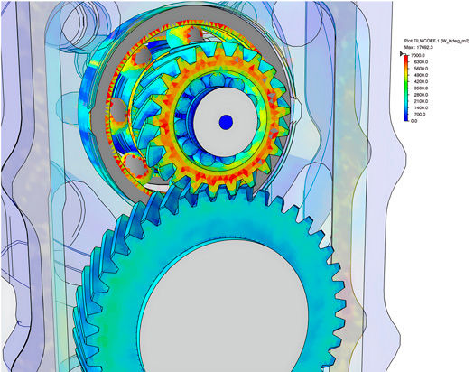

The heat transfer coefficients (HTC) are scalar values projected onto all surfaces and can be exported for each part into a text file containing the HTC values and the associated node coordinates (x, y, and z). The user must select a time span during which the flow is fully developed, typically covering at least one rotation of the slowest gear. For each time increment within this period, a text file must be exported. During the heat transfer analysis, the mesh is static, so the node coordinates from the initial increment must also be exported. These initial node coordinates are then associated with the average HTC values at each node, for every part. This process is automated using a Python script. Once the HTC values are processed, they can be imported into the heat transfer analysis to predict the temperatures accurately.

Next, the heat transfer coefficients (HTC or film coefficient) at each node were imported to define film conditions that characterize the convective heat exchange, along with an estimated fixed lubricant temperature. Figure 10 illustrates the mapping of the film coefficients on the gears around the narrow region. Given the highly turbulent nature of lubrication inside the casing, assuming a constant temperature throughout is acceptable. The lubricant temperature can be easily adjusted to run multiple scenarios, allowing for the study of its sensitivity on the predicted solid temperatures.
Figure 10—Cut view inside the gearbox showing the convective heat transfer coefficients projected on solid surfaces.

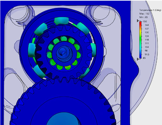

The main output is the predicted temperatures of bearings and solids for a particular load case. Figure 11 shows the predicted temperature with the deflector.
Figure 11—Predicted temperature around the narrow region with the deflector.
In reality, the temperature should be uniform on all bearing rollers due to their high rotational velocity. But considering that the film coefficients are averaged during just one simulated second, to keep calculation cost reasonable, and that the heat transfer analysis is steady state with fixed geometry, a temperature gradient can be observed on the bearing. To remain conservative, the maximum predicted temperature can be used. This misrepresentation of reality is explained by numerical reason, but the interpretation of the results remains acceptable and allows for design comparison and performance evaluation. According to the bearing spec sheet, the bearing could start to accumulate damage above 150°C. The analysis prediction of a maximum bearing temperature of 176°C correlated well with the manufacturer’s damage observations on the roller bearing.
Figure 12 reveals the same prediction of temperature without the deflector. It clearly confirms the fact that the lubrication appeared to be better without the deflector, offering better cooling of the overheating bearing.
Ironically, the manufacturer attempted to solve the anticipated overheating problem with the deflector actually exacerbated it.

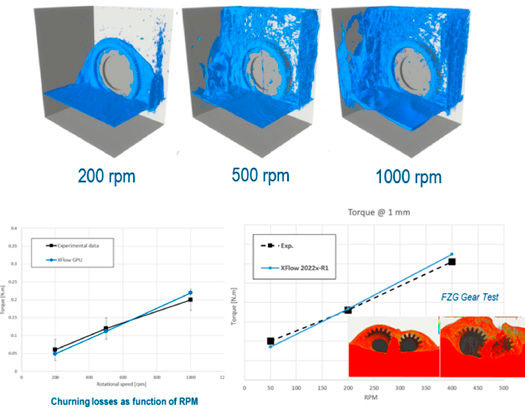

Correlation of the developed workflow is an essential step to ensure its accuracy and reliability. The process involves several stages, beginning with the visual comparison of lubricant splashing. Slow-motion videos recorded using high-speed cameras are matched with animations generated from the CFD analysis. This visual correlation provides a qualitative assessment of the simulation’s accuracy in replicating real-world conditions.
The second stage involves measuring the churning loss of the gearbox. The total torque loss on the test bench includes bearing losses, gear friction, seal friction, and churning losses. Accurate evaluation of the other three components is necessary to isolate and compare the churning losses with the torque measured in the CFD analysis. This quantitative comparison validates the simulation’s accuracy in predicting torque losses due to lubricant movement. The solver has been validated based on comparison with experimental data (Ref. 4). Two different scenarios, one single gear and two engaged gears, are tested experimentally and compared with numerical prediction. Figure 13 shows the comparison of experimental versus numerical churning losses estimation using XFlow 2022 solver. It shows a good correlation at various speeds.
Figure 13—Correlation of churning loss measurements between experiments and numerical predictions (Ref. 4).
Temperature measurements represent the third stage of validation. Temperature data collected on the test bench are compared to the simulated overheating conditions. Ensuring that the CAD model used in simulations accurately represents the prototype on the test bench is critical for this comparison. The same lubricant temperature, applied torque, and rotational speeds must be represented in both physical and simulated environments.
In our project with the gearbox manufacturer, the prototype on the test bench was an earlier version of the design. The test bench lacked a sensor capable of measuring torque losses, which would have allowed us to extract the total churning loss. Additionally, a few temperature labels were installed on shafts that had been altered between the prototype and the CAD model. These labels provided a range of temperatures reached or indicated if the maximum temperature had been exceeded.

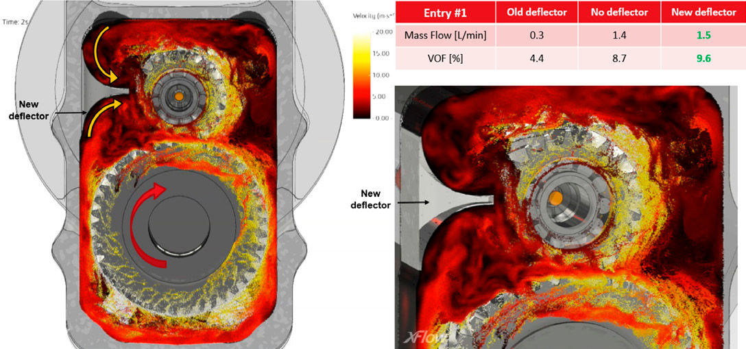

In the context of our project, the virtual lab allowed for testing several deflector designs intended to guide more lubricant towards the overheating bearing. The initial deflector design created local lubricant recirculation, which was impossible to detect experimentally. Simulations provided critical insights, revealing the inefficiencies of the initial design and guiding the development of optimized deflector configurations. The improved deflector design, shown in Figure 14, was based on the animations of the lubricant movement. It uses double slopes directing both the flow coming up on the left side wall, and the flow moving counterclockwise around the input gear.
Figure 14—Qualitative and quantitative results using the new deflector, showing better lubrication performance compared to the initial deflector design.
No recirculation pattern, nor low velocity areas were observed. Figure 14 shows important lubricant motion near the overheating bearing. The table presents the comparison of flow quantity accessing the overheating bearing, indicating better performance. The improvements compared to without the deflector were not significant, but it shows that virtual testing allows us to quickly evaluate and compare designs.
Quantitative metrics such as churning loss, volume flow across surfaces, and temperatures allow for the ranking of different designs and sensitivity studies. This ranking helps design teams identify the most effective configurations and better understand the parameters that most significantly affect lubrication performance. By providing detailed insights into the lubricant distribution and heat transfer characteristics within the gearbox, the virtual model enables the development of more efficient and reliable designs.
