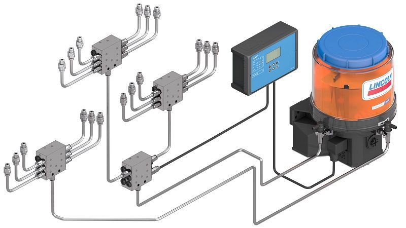

Single-line automatic lubrication systems
A pump delivers lubricant to an (adjustable) metering device that services the lubrication points, delivering a precise amount of grease or oil. Single-line lubrication systems can be used to service one machine, different zones on one machine, or several separate machines. Monitoring is done by sensors that monitor system pressures and send signals to the control unit at preadjusted critical values. The control unit enables lubrication to be triggered automatically at predetermined intervals. Single-line lubrication systems can serve up to 900 lubrication points in machines over distances of up to 100 meters. Smaller systems are fed by compact pump units incl. lubricant reservoirs, bigger systems are fed by barrel pumps. Installation is easier than with a progressive grease lubrication system, but the initial investment in a single-line grease lubrication system may be higher.
Progressive automatic lubrication systems
This is the most common lubrication system in food and beverage industry. It can be used on small to medium sized machines with dispersed lubrication points that require varying quantities of grease or oil. Progressive lubrication systems consist of a pump connected to a primary metering device, outlets from which are connected via pipes or high-pressure hoses to the lubrication points of the filling machine. The pump supplies lubricant to the meter, which splits the lubricant into predefined amounts, which in turn are pumped to the lubrication points or – alternatively – to the inlet of a secondary metering device, thereby enabling more points to be lubricated. Progressive lubrication systems can dispense a precise, metered amount of lubricant to up to 150 lubrication points over distances of approximately 15 meters.
