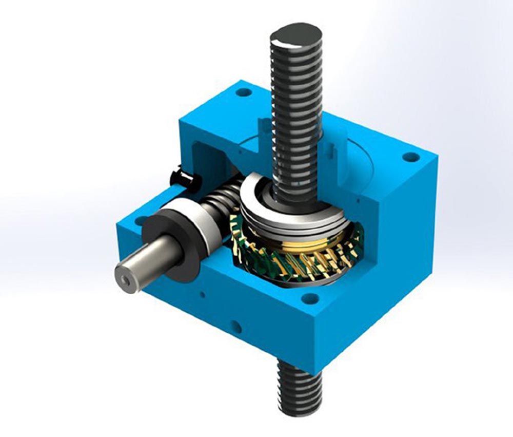

The traditional screw jack design consists of a metal plate supporting a rounded gearbox with a trapezoidal screw on top. Although this design is well-established, it has a drawback: To install the gearbox, it must connect directly to the metal plate and users must specify the screw jack’s orientation based on whether it will be subjected to either a compression or traction load. The flanged design also presents a potential weak point where the metal plate connects to the round section of the gearbox.

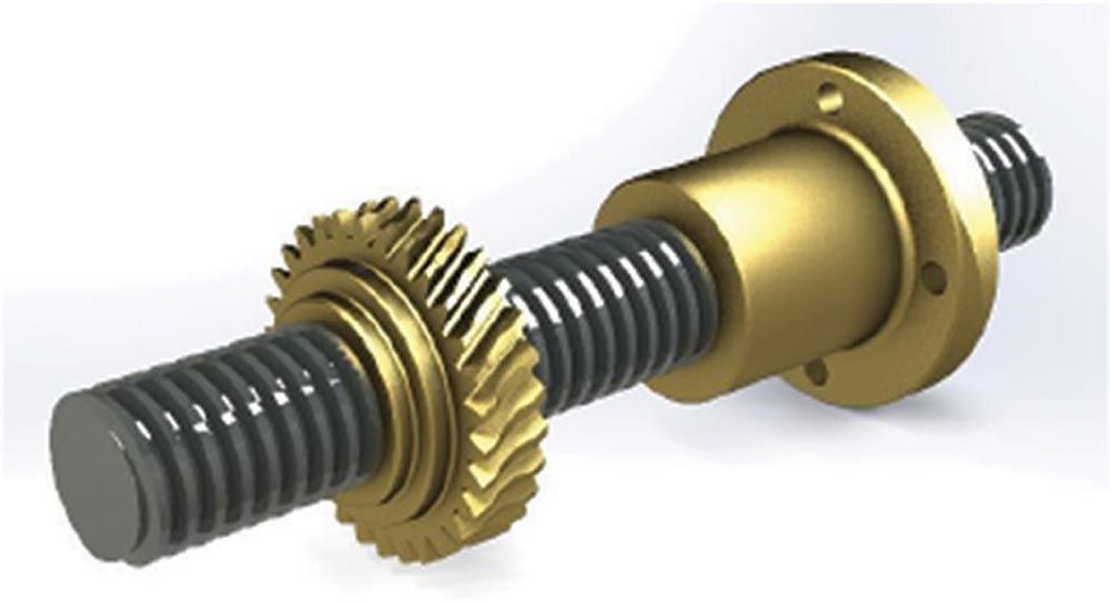

Technopolymers are high-strength plastics that outperform conventional plastics, especially when it comes to resisting heat and mechanical stress. When reinforced with fiberglass, they offer very high strength and rigidity as well as good creep resistance. In addition to these advantages, a technopolymer can work without lubricants—a desirable trait in many food industry applications.
