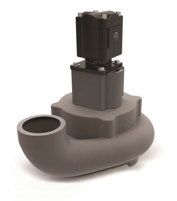

Providing a solid connection and mounting platform for a pump impeller can be especially challenging in underwater applications. Typical of these are agitation systems in water treatment plants that include aerators, agitators and scrapers that operate underwater 24/7 and require minimal maintenance for long periods of time.
Specially designed submersible Overhung Load Adaptors (OHLA) from Zero-Max handle these underwater drivetrain stress conditions. Key components are designed with chrome, nickel plating, or QPQ finish to withstand harsh, corrosive underwater conditions.
