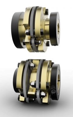

The challenge was connected motion components in a composite fiber processing system that needed extra parallel misalignment capacity to prevent premature bearing failure and oil leakage. The solution was a custom, shortened Double Flex CD Coupling from Zero-Max.
In this application, the original machine design called for a single flex, steel disc coupling to connect the system motor to a gearbox.  When operating, the steel disc coupling did not allow enough parallel misalignment to protect the connected components from excess stress and wear. Component failure resulted, causing system downtime, with excess cost and time for restart of the equipment.
Drawing from experience, Zero-Max engineers proposed a shortened version of its Model 6P60C CD coupling. Designed with a composite disc center member, this coupling handles the misalignment, minimizing reaction loads in a confined operating space much better than the previously used steel disc coupling.
Providing a peak torque value of 12,700 in-lbs, the CD Coupling is torsionally stiff and able to operate at speeds up to 4,400 rpm, far above the system’s upper performance requirements. The custom CD Coupling ensures very low reaction loads on the system’s shaft bearings. This custom CD Coupling provides up to 3 degrees angular misalignment with 0.069 (1.8 mm) parallel and 0.260 (6.6 mm) axial misalignment also allowed. Another nice feature, the coupling has aluminum hubs that have very little inertia.
The newly modified coupling provided a straight forward solution. It was easy to install by simply removing the failed coupling and connecting the newly modified CD Coupling’s clamp- style hubs in the system’s powertrain, without having to redesign or relocate any machine components.
