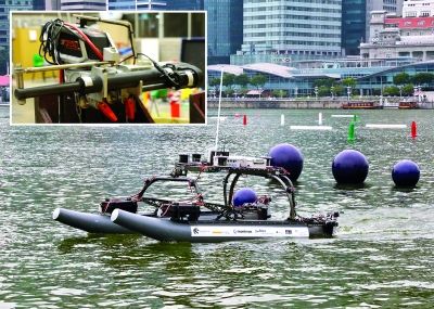

Each team was provided with a 16-foot (5 meter) Wave Adaptive Modular Vessel (WAM-V) that needed to be equipped with propulsion, guidance and sensors that would enable it to complete a set of predetermined tasks. Each challenge, which included detection and avoidance of obstacles, as well as an underwater search for an acoustic source, was designed to test the design and implementation of the sensors and control systems.
One of the more basic elements of the design are the propulsion and steering systems that have to be integrated with the vision and guidance systems so that the vessel can avoid obstacles. The team from Newcastle chose to design a linkage that turned the electric outboard motors using linear actuators.
Following some initial research, the designers contacted Warner Linear to discuss the challenge and find a solution. Based on the team’s design requirements, Warner engineers configured two identical K2x ball screw linear actuators, which operate at 24 VDC, with a 2,800 lbs (1,270 kg) load capacity. The 12” (300 mm) stroke and 5:1 gear ratio offered the required speed and torque to provide fast and accurate steering control, while the position feedback would provide the necessary information for the guidance software.
Nicolas Weightman, student team leader - hull mechanical and electrical comments: “While we didn’t win the competition, the pair of donated Warner Linear actuators definitely gave us the advantage of being able to outmaneuver most of the other teams. We wouldn’t have been able to run such a steering system without their help.”
