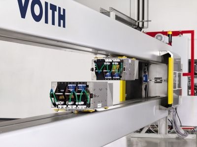

With the newly launched fiber orientation measurement and control of Voith's OnQuality product family, paper manufacturers can reliably control the fiber orientation angle. The new solution consists of the OnQ Fiber Orientation Sensor, which continuously measures fiber orientation in real time; the OnQ Profilmatic fiber orientation control system; and the OnQ ModuleStep and OnQ ModuleJet actuators.

The OnQ Fiber Orientation Sensor uses high-resolution macro photography, digital image processing and nanosecond flash illumination to distinguish the individual fibers and their orientation in the moving paper web. Surface measurement is possible on both one and two sides. The OnQ Profilmatic CD control system derives suitable set points of the OnQ ModuleStep actuators from the measured fiber orientation angles, which enable zonal, mechanical profiling of the headbox slice lip using stepper motors. In combination with the OnQ ModuleJet actuators, the dilution water can also be controlled, thus avoiding undesirable side effects on the basis weight.
