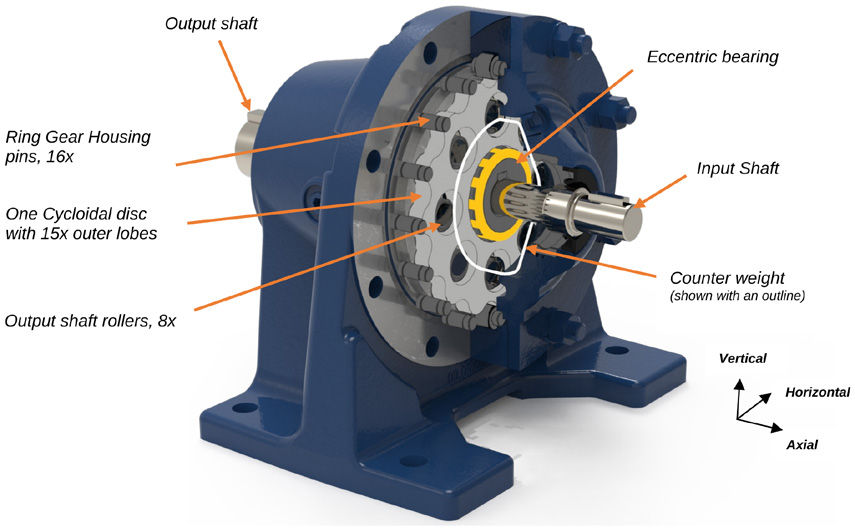

For years, the cycloidal reducer (Figure 1) has proven its performance in a variety of applications, from robotics to wastewater treatment. Along with involute gearing, the cycloidal mechanism has its place in the mechanical power transmission world. It is well known for its high torque density, high integer ratio per stage, and shock load handling capabilities. Its poke-yoke assembly refrains from introducing any errors during assembly and allows the unit to operate with low maintenance. Despite these advantages, the reducer may have a variable angular speed at its output shaft, in large part due to manufacturing imperfections. A constant transmission ratio during gear meshing can be attained with involute gearing by following standardized methods established in the gearing industry (Ref. 1). Considering the manufacturing deviations and loading conditions, one could optimize the macro and micro geometries of the involute gearing and get a fairly controlled transmission error. In the case of cycloidal gearing, however, the same may not hold. The steadiness of the ratio, or the output shaft's angular velocity, will vary with the cycloidal gearbox manufacturer. Small dimensional deviations in rotating components, such as the cycloidal disc and rollers, will influence the variations in the output shaft rotation. The torque load on the output shaft also induces the variation. Such scenarios have the potential to negatively influence traditional vibration-based fault diagnosis methods.
Figure 1—Cross-section of the cycloidal reducer used for vibration data collection (FFT and wavelet analysis), with probe axes (vertical, horizontal, axial) labeled at right.

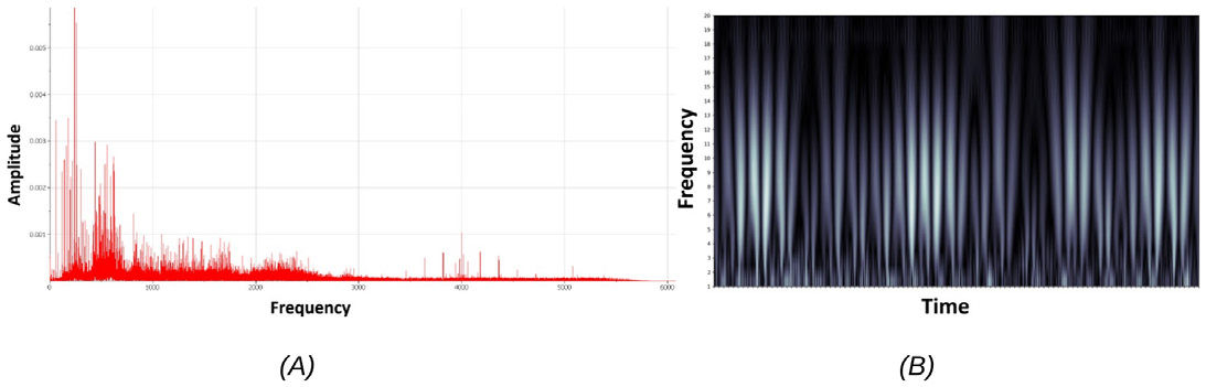

The FFT-processed signal has no time (or phase) related information in it. The nonstationary signal raises a need to know when an event has taken place on a timeline, along with its appearance on the frequency scale. Analyzing the separate graphs of time and frequency side-by-side may not be intuitive. If one tries to put time and frequency on one graph, it is well known that Heisenberg’s Uncertainty Principle would allow resolution of the signal for one of the components (time or frequency), but not both. To overcome this limitation, various time-frequency analysis methods were developed by sacrificing some resolution in both components. Among those methods are the short-time Fourier transform, Wigner-Ville Distribution, and wavelet transform (WT) (Ref. 3). Typical graphs of FFT and WT are shown in Figure 2 for comparison purposes. Each line in the FFT graph represents a frequency with a certain amplitude, whereas in the WT Scalogram, the brightness of each band signifies the strength of the frequency component in a specific frequency range seen on the Y-axis, at a certain time.
Figure 2—(A) A typical Frequency spectrum obtained from Fast Fourier Transform, (B) A typical Scalogram derived from Continuous Wavelet Transform (WT).

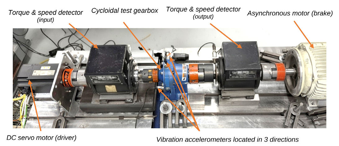

The vibration measurements were carried out on a test stand shown in Figure 3. A Sumitomo cycloidal gearbox of a 15.00:1 ratio was selected for the experiment. CNH-609 gearbox was specifically chosen as it consists of one cycloidal disc (Ref. 17). In lieu of the second disc, which exists in a typical cycloidal reducer, this gearbox design uses a counterweight to achieve dynamic balancing (refer to Figure 1). The one-disc mechanism simplifies the analysis and allows focusing on certain frequencies. In the setup, the gearbox was driven by a DC Servo motor with an encoder feedback loop to provide a consistent speed of 1,800 rpm (30 Hz). The DC motor’s torque capacity was 2.39 Nm. The output shaft of the gearbox was connected to the asynchronous motor that acted as a brake. The torque and speed were measured using torque meters and encoders, respectively, for both input and output shafts. Three vibration sensors (sensitivity 87 mV/g at 6000 CPM) were mounted on the gearbox to collect tri-axial vibration data. All measurements were recorded using the National Instruments Data Acquisition (NI DAQ) system at a sample rate of 12.8 kHz for vibration and 10 kHz for torque measurements. For the input shaft spinning at 30 Hz, the DAQ system would generate 426 and 333 data points for vibration and torque, respectively, in one revolution of the shaft.
Figure 3—Cycloidal gearbox vibration measurement setup.

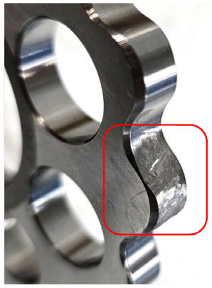

The gearbox was assembled with the standard lubricant using an NGLI 00 grade grease, with a predefined quantity. To confirm that all test iterations were performed at a steady temperature, the test stand was placed in a climate-controlled room with an ambient temperature of 21°C. Two temperature probes were placed to monitor the reduction housing or ‘ring gear’ housing of the gearbox. The load on the reducer output shaft was varied from 0 Nm to 15 Nm during the experimentation. The gearbox was tested for a healthy condition, meaning it had no induced errors. Then it was tested for a worn-out cycloidal disc or damaged condition by swapping out the normal disc with the one seen in Figure 4. Other than the disc, the use of the same parts in both conditions ensured that there were no other changes to influence the vibration data. It is important to highlight the fact that the induced change in the ‘damaged’ condition is relatively small. The goal of the testing was to gather vibration data and analyze it with FFT and multifractal analyses.
Figure 4—“Damaged” cycloidal disc with a simulated worn-out lobe (highlighted). This was achieved by removing material from the lobe flank and increasing the surface roughness.
Referring to Figure 1, the cycloidal reducer utilized for the experiment has a cycloidal disc with 15 lobes. These lobes engage with 16 ring gear housing pins when the eccentric bearing sways the disc with its eccentricity. The ‘engaged’ disc (with pins) then generates a rotary motion while it is swaying and forces the output shaft to spin with the reduced speed in the opposite direction. The connection between the disc and the output shaft is achieved by engaging 8 output rollers within the 8 holes of the disc. This information helps to determine the mesh frequencies. The disc-pin mesh frequency is 16x order. The disc-output shaft roller mesh frequency is 16x8 = 128x order.

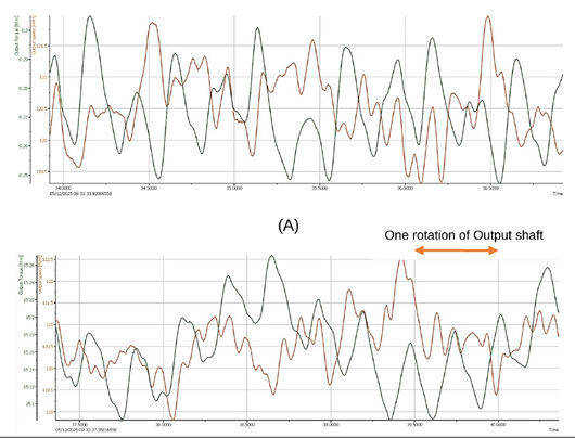

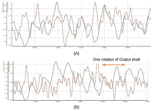

Figure 5 and Figure 7 show the torque and speed curves for healthy and damaged gearbox conditions. Each condition has 0 Nm and 15 Nm loads. Both torque and speed curves depict the steadiness of the power (proportional to the product of torque and speed) flowing through the system by generally showing opposite trends to each other. The variation in those curves over the period of three seconds confirms the randomness of the signal, hence categorizing it as a nonstationary signal. The FFT would assume the same signal as stationary, i.e., the signal not varying with time. This assumption ignores the local irregularity or fractals, and hence potentially any evidence of the fault existence. When the signal of one second period was FFT processed and plotted against the RMS amplitude in m/s2 (refer to Figures 6 and 8), the aforementioned cycloidal mesh frequencies can be observed.
Figure 5—Healthy reducer: Output Torque and Speed curves at (A) zero load and (B) 15 Nm load, over three seconds.

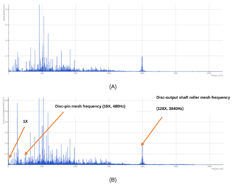

Figure 6—Healthy reducer: Fast Fourier Transform at (A) zero load and (B) 15 Nm load, data shown for the “vertical” axis.
Figure 7—Damaged reducer: Output Torque and Speed curves at (A) zero load and (B) 15 Nm load, over three seconds.

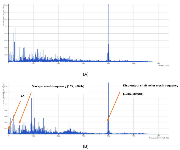

Figure 8—Damaged reducer: Fast Fourier Transform at (A) zero load and (B) 15 Nm load data shown for the “vertical” axis.

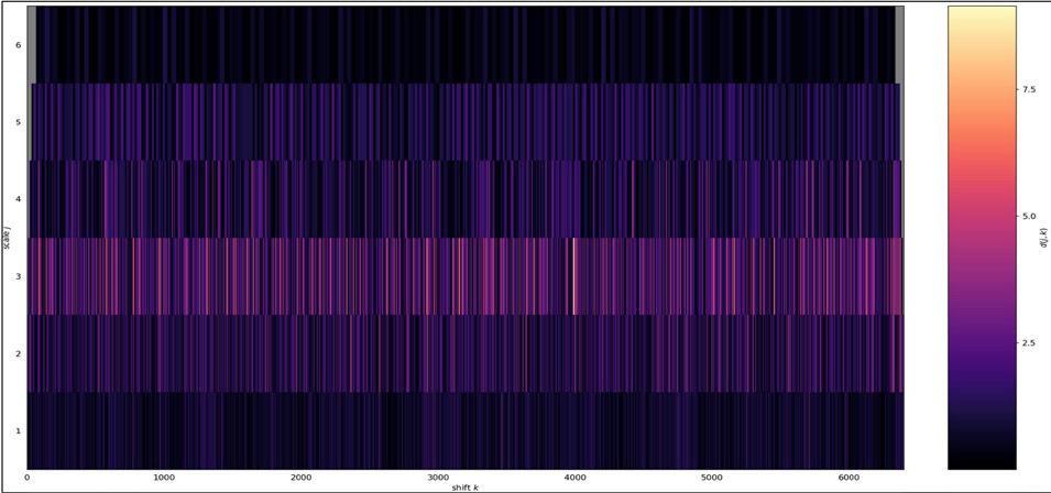

A typical way to diagnose any faulty machine using vibration is to compare its pre- and post-incident data, which means comparing the healthy (Figure 6) and the damaged reducer (Figure 8) graphs. However, apart from observing the higher amplitudes across the spectrum, it was incomprehensible to establish any relation with the fault by utilizing known frequencies (highlighted in graphs). Even at 16× order (disc-pin mesh frequency), where the fault was induced, no noticeable relative data change was observed. The same time period (one second) vibration data was then analyzed with WT, by plotting the Scalogram shown in Figure 9. As discussed in the “Introduction” section, the Scalogram or “Frequency vs Time” graph generally reveals the dominant frequencies at a time instant inside the non-stationary signal. Figure 9 shows a burst in localized activities, confirming the existence of mono- or multifractality in the signal generated by the damaged gearbox. Equations 4–8 were used to perform Multifractal analysis to extract wavelet coefficients that built the Scalogram, to derive the multifractal spectrum. The multifractal spectrum is plotted in Figure 10 for all three axes of vibrations: vertical, horizontal, and axial. The axis diagram, referred to in Figure 1, has the reducer shaft axis aligned with the vibration axial direction, and the remaining axes are in the radial direction of the cycloidal disc.
Figure 9—DWT Scalogram for damaged gearbox in vertical direction over 1 second time period, under 15 Nm load. Shift k on the X-axis represents the time, and scale j on the Y-axis corresponds to the frequency. The higher the value of j, the lower the frequency. The color change shows variation in the magnitude of wavelet coefficients. The lighter color indicates stronger local fluctuations.

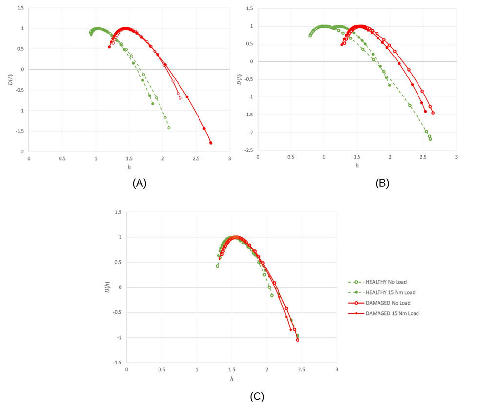

Each graph in Figure 10 consists of four curves showing different operating conditions of the gearbox: a healthy reducer with no load, a healthy reducer with 15 Nm load, a damaged reducer with no load, and a damaged reducer with 15 Nm load. Based on their positioning on the graph, the curves can visibly be sorted into healthy and damaged groups (green color and red color, respectively) in Figure 10(A) and Figure 10(B). The damaged gearbox’s curves are shifted towards the right side of the multifractal spectrum, making them separated from the healthy ones. It can be argued that the main cause of this distinction was the induced damage on the cycloidal disc. The worn-out surface on the disc generated singularities affecting the wavelet coefficients, subsequently creating a deviation in the multifractal spectrum in radial directions. The axial axis graph, Figure 10(C), does not show similar shifting, as the worn-out lobe of the disc would not have energy change in this direction. The loading conditions, 0 Nm and 15 Nm, do not noticeably influence the shifting in all three graphs.
Figure 10—Multifractal spectra for healthy and damaged conditions measured in (A) vertical, (B) horizontal, and (C) axial directions. The multifractal spectrum D(h) is plotted against h, the Hölder exponent.

The paper compares results of the two tests conducted on the same gearbox. The only difference between the two test setups was the condition of Cycloidal disc, depicting ‘healthy’ in one and ‘faulty’ in another. The multifractal spectrum clearly distinguished the vibration data with respect to their conditions, which Fast Fourier Transform graphs could not. This paper argues that the wavelet transform based multifractal analysis approach makes the Cycloidal gearbox diagnosis less ambiguous compared to FFT. This is mainly because the collected vibration signals were time dependent and the singularities in the signal cannot be captured using FFT. The multifractal spectra also showed that the load on the gearbox output shaft does not significantly influence the curve shifting or the Hölder coefficient. For the future work, it is worth exploring the ‘worn-out’ effect of other Cycloidal gearbox components, such ring gear pins, output rollers, on the multifractal spectrum and establish the changes to be utilized in fault diagnostics.
