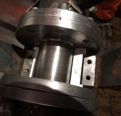

Vesconite’s Hitemp 150 hangar bearings have been installed at a palm oil processing factory in Cameroon, Central Africa.
This followed a suggestion to test Vesconite Bearing’s most abrasion-resistant polymer - which also has a high-temperature rating. Abrasion resistance is important for a bearing’s success since wear can result in frequent replacement and factory downtime, while a high temperature rating means that the product can be fitted to screw conveyors with high volumetric flow rates.
