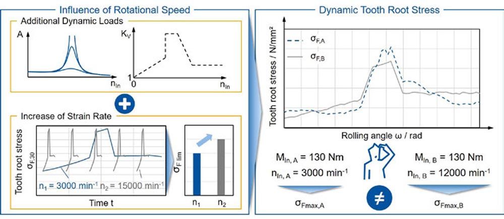

Figure 1 Speed influence on the fatigue strength.
Introduction and Motivation
The development process for gear transmissions in the fields of electric mobility and turbomachinery is characterized by increasing requirements with regard to the transmitted power, the required installation space, and the operating conditions. On the one hand, the increasing electrification of powertrains is causing an increase in operating speed (Ref. 20). On the other hand, due to the high-efficiency requirements in aircraft engines, gearboxes with extremely high power requirements and operating speeds are used (Ref. 33). Due to the increasing speeds in the powertrain, the power transmitting components are loaded with a high number of load cycles and the load speed is increased Ref. 5). The gears used, achieve load cycles in the Very High Cycle Fatigue (VHCF) range with 107 G 8 load cycles (Ref. 29). This can lead to a decrease in fatigue strength depending on the material and surface treatment (Refs. 6, 32). For gears in high-speed applications, methods for determining the remaining service life of a component in operation are necessary. On the one hand, the acquisition of condition data by means of suitable sensors for continuous monitoring is required. On the other hand, an intelligent evaluation of these data to assess the condition of the component must be developed. Crucial for a correct calculation is the material strength at the operating point and the real stresses in the high-speed range.
Investigations in materials engineering show that steels exhibit a pronounced dependence of the load-carrying capacity on the loading speed during plastic as well as elastic deformation (Refs. 1, 13, 24, 28, 31). The left part of Figure 1 shows the speed-dependent influences on the material stress and strength of the tooth root. On the one hand, variable, additional dynamic loads occur during operation due to the tooth excitation as a function of the rotational speed. These are taken into account in the load capacity calculation of the ISO 6336 using the speed-dependent dynamic factor KV (Ref. 22). On the other hand, the increased speed leads to a significant increase of the strain rate in the tooth root, since the time interval of one gear mesh decreases while the maximum stress remains nearly constant. A classification of previous and future strain rates in gear applications in the state of the art shows that the strain rates in the tooth root of gears reach or exceed the values from the state of the art (Ref. 5). The investigation of the influence of the strain rate in the tooth root on the tooth root load capacity has not been carried out in the current state of the art.
The investigation of the strain rate influence on the tooth root load carrying capacity requires the consideration of different speeds in the test. The right part of Figure 1 shows the influence of the speed on the maximum tooth root stress in operation. Due to the speed-dependent tooth excitation, it is to be expected that the maximum tooth root stress will vary at different speeds as a result of the dynamics. Before determining the tooth root load carrying capacity in the test, it must therefore be ensured that the influence of the strain rate on the tooth root load carrying capacity is not superimposed by the influence of the dynamics and incorrect conclusions are drawn. A validated method for calculating the local and time-related tooth root stress at variable operating points, taking dynamics into account, is required to differentiate between these influences on the stress and strength in the tooth root.
