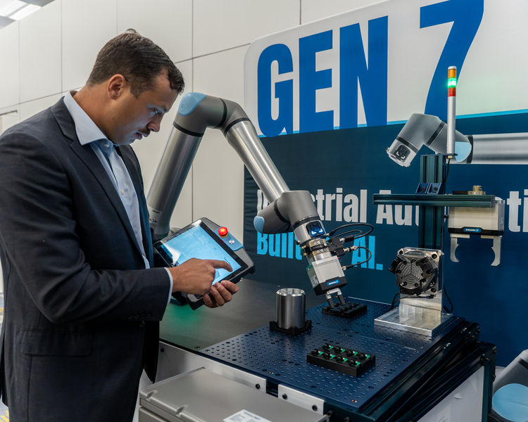

The TP7 Core teach pendant is more than 20 percent lighter than earlier pendants. It has multiple grip positions, configurable smart buttons, a full HD display and a virtual joystick. The new SP7 Smart Panel mounts at the tool flange so operators can teach and program at the point of the task. It provides safety-compliant freedrive, LED indicators and three configurable input buttons that can run PolyScope X Smart Skills. UR is aiming the panel at high-mix, low-volume production, where operators frequently teach the robot by hand.
