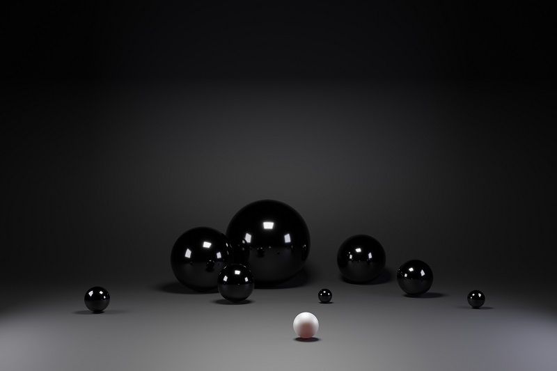

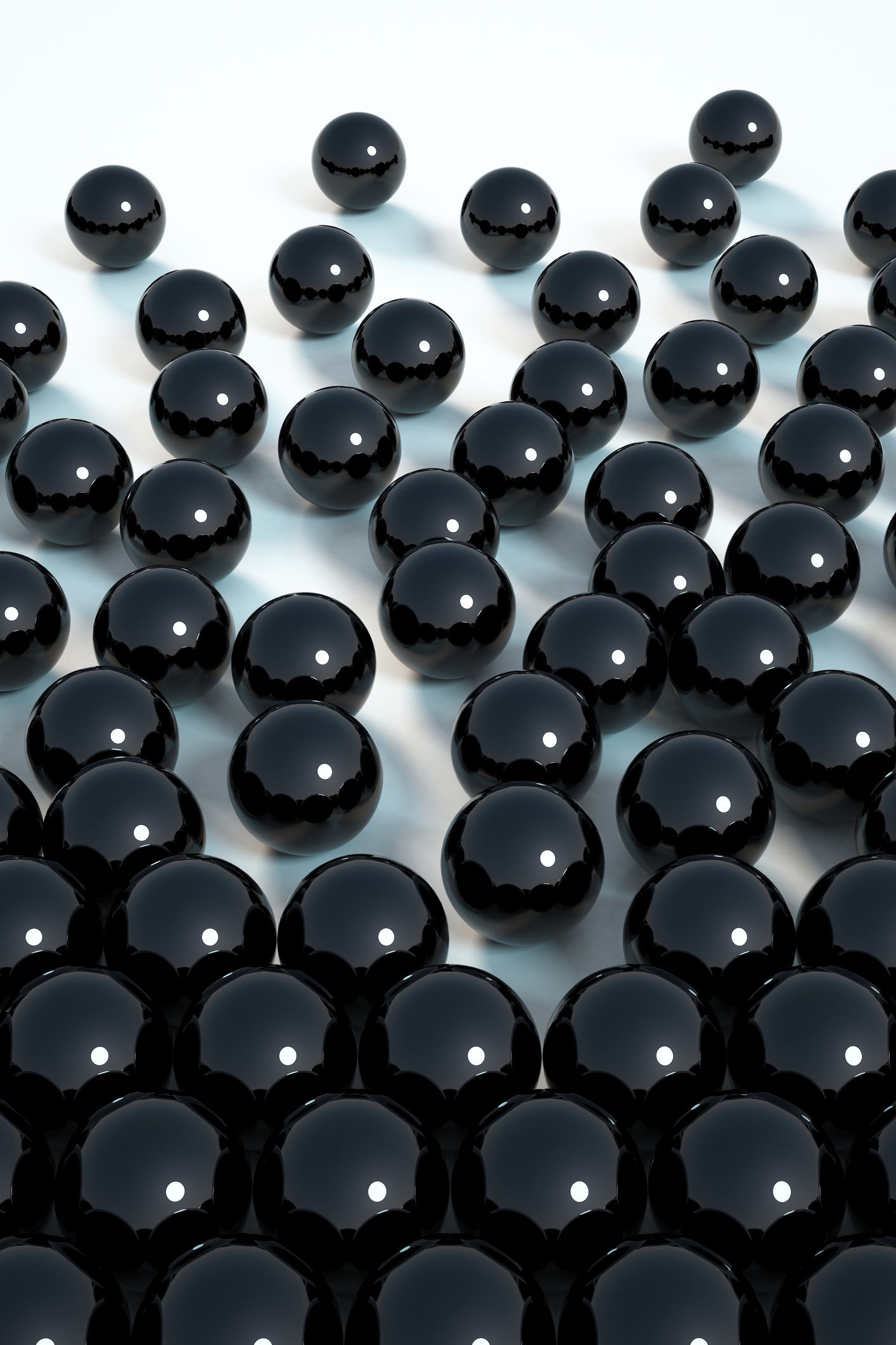

Ceramic Balls can be considered the new frontier in product developments suitable for bearing and high-performance applications. Above all, they are a specialty product line of the company which are commonly used for: hybrid bearings, machine tools, electric motors, fuel injection systems, wind energy and valves.
Ceramic balls are made with Aluminum Oxide, Zirconium Oxide and Silicon Nitride. These components allow great efficiency and high performance. Among ceramic balls, Silicon Nitride balls (Si3N4) have proved to be an ideal solution in many applications because of their advanced characteristics. Silicon Nitride ball production specifically helped Tsubaki Nakashima to be well known and present in major EV platforms. The company produces silicon nitride balls in its plants in the United States, in Japan and in Thailand, with a large variety of dimensions suitable for every use (from 0.5 to 86 mm) and with a focused attention to the origin and the quality of its blank materials and to the production process. This is fundamental to offer the best performances to customers.
The production process
Ball blanks are sintered ceramic balls. The material is prepared by special processes at very high temperature, pressure on inert atmosphere for reaching highest properties. The result is a spherical shape which is the ball blank. The grinding operation removes the slight belt and small protrusions left on the surface faces, by rolling them between two hard alloy plates under high pressure. The next step is the lapping operation. Flashed balls are rolled between two cast iron plates. One plate is fixed while the other is rotated at a very low speed. The real secret of the extreme quality of precision balls happens here. At this stage the sphericity and size have been established and are carefully inspected according to ASTM F2094 standard and customer requirements. The final production operation is polishing which adds the shiny luster to the finished ball. The balls are inspected visually and/or mechanically.
