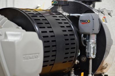

Trico Corporation, a provider of lubrication management solutions, recently introduced Sensei, a real-time lubrication intelligence system. Sensei wirelessly transmits oil level and ambient air temperature to a customizable, web-based dashboard. As a result, users gain real-time input on machine status and maintenance requirements.

The first wireless sensors available as part of the Sensei system are oil level sensors designed to accompany Trico’s line of 8-oz. Opto-Matic vented and closed constant level oilers. Pumps, motors, gearboxes, fans, blowers and other equipment use constant level oilers to maintain a consistent fluid level.

“Sensei has helped us rule out and identify problems,” says Mike Walton, ICML, MLT-II, Mechanical Technician at Irving Tissue, St. John, New Brunswick. Irving Tissue tested Sensei on the Yankee Exhaust Fans that assist in the drying process. Walton notes that the reliability team at first thought one fan had an oil leak because it lost so much oil in a short period, but historical data provided by Sensei showed that there were periods as long as four to five months where oil level stayed constant.
“On fan 200-190-21, Sensei enabled us to rule out a leak and look for other causes,” says Walton. “Conversely, fan 100-190-53 leaked constantly. On closer examination, we found it had a leaking fitting going to the bearing housing, as well as a bad seal. Work orders were entered to correct those problems.”
