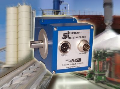

TorqSense Sensors Measure Torque Without Slip Rings
TorqSense Rotary Torque Sensors, made by Sensor Technology Ltd., are unlike traditional slip ring transducers. They use a simple non-contact radio link for collecting real-time torque signals, letting machine builders and control engineers can do away with expensive and temperamental slip rings. Thus simply mounting the sensors and checking the radio connection is all that is required to set up a TorqSense.
Electronics convert the data stream directly into engineering outputs, such as torque, speed, power and angle. Serial and USB interfaces make TorqSense directly compatible with PCs and other user-friendly features include built-in peak torque sampling, storage and torque averaging, and a self-diagnostics test package. The electronics can be provided, integral with the main unit or in a separate housing, to suit individual applications.
To achieve the non-contact operation that makes the TorqSense transducer range unique, SAW (surface acoustic waves) devices are used as frequency-dependent strain gauges to measure the change in resonant frequency, caused by strain experienced in the driveshaft. This measurement is directly related to the torque experienced in the rotating machine element.
In use, SAW devices are mounted onto the shaft and their output signals are transmitted by a low-power radio frequency (RF) coupled to an adjacent pick-up, which interprets the signals and converts them into a torque measurement readout or feeds them on into a PC for further calculation.
