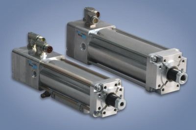

New ServoWeld actuators from Tolomatic are redesigned for higher performance and are lighter weight compared to other screw technologies. Featuring roller screws designed and manufactured by Tolomatic, the ServoWeld actuators are made especially for resistance spot welding (RSW) applications in the automotive industry. The ServoWeld actuators deliver 20 million welds or more, much longer than competing technologies such as ball screws and inverted roller screw actuators, according to Tolomatic.
The ServoWeld Advanced (SWA) actuator is based on the highest level roller screw technology available to deliver the maximum number of welds. The ServoWeld Base (SWB) actuator is built on an alternate roller screw design to provide longer life than typical ball screw and inverted roller screw technology, but at a more economical price than the GSWA actuator.
The SWA and SWB ServoWeld models are available in two sizes: a smaller size 3 for lighter-duty weld schedules; and a size 4 for heavier-duty applications. Both sizes are available in a variety of roller screw thread pitches (5 mm and 10 mm), motor voltages (230 Vac & 460 Vac) and multiple options for rod ends, feedback & connectors, and water cooling. These models can produce actuator forces at the rod up to 4,000 lbf/17.8 kN, lasting 20+ million welds and holding +- 3 percent force repeatability over the life of the actuator.  Each model comes equipped as standard with a re-lubrication port to easily service the actuator without disassembly from the weld gun to maximize its life.
Tolomatic has extensive experience in the automotive resistance spot welding industry with its predecessor product, the GSWA ServoWeld actuator. Because of this experience, the ServoWeld SWA and SWB actuators have motor files for seamless robot integration with all the major suppliers including ABB, Comau, Fanuc, Kawasaki, Kuka, Motoman, Nachi and many more.
