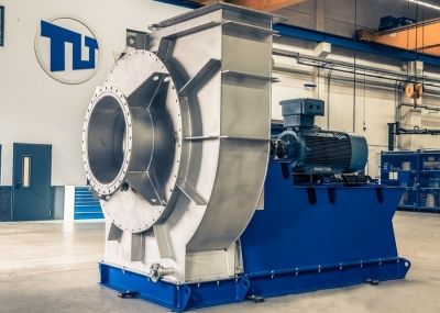

TLT-Turbo GmbH, a global ventilation fans and systems manufacturer, has launched a new range of mechanical vapor recompression fans, with ceramic hybrid bearings that provide an exceptionally long operational lifespan. Integrating the latest ventilation technologies, this fan offers numerous advantages regarding performance efficiency, minimal maintenance and high reliability.
The TLT-Turbo fan for mechanical vapor recompression (MVR) has been in development since 2012 since the first case studies were carried out. Following intensive discussions with clients, TLT-Turbo established that a need existed for low maintenance MVR fans. This was followed by four years of intensive research, product testing and consultations with clients. The first MVR fans were rolled out in 2016 while continual product improvement has remained a focus area for TLT-Turbo.
“MVR fans have been available on the market for some time but instead of just following the trend, TLT-Turbo took time to ensure that we came to the market with a completely new, state of the art MVR solution,” says Mario Schmidt, head of TLT-Turbo’s Vapor Fans business segment. “And we continue to have on-going discussions and feedback exchanges with our clients worldwide in order to continuously adapt and improve our MVR offering to their requirements.”
According to Schmidt, the features of TLT-Turbo’s MVR fan, such as the lower maintenance requirements and the introduction of hybrid ceramic bearings, underscores their commitment to developing products in close alignment to their clients and their needs, and also speaks to TLT-Turbo’s key objective for continual innovation.
The implementation of hybrid ceramic bearings is a key differentiator of the TLT-Turbo MVR fan. “Our clients are amazed by the possibility of a hybrid bearing operating at high speed without circulating oil. Conventional roller bearings do not provide the required support for operating the fan in a broad operational speed range without running into harmful resonance frequencies (under critical operation). Thanks to continuous enhancement in recent years, especially through the use of ceramic materials, more effective roller bearings are available today. The use of hybrid bearings with steel rings combined with ceramic rollers has been established in many industrial applications and in the case of the TLT-Turbo MVR fan, hybrid ceramic bearings mean significantly lower maintenance requirements and better operational performance,” Schmidt explains.
The hybrid ceramic bearings used in TLT-Turbo MVR fans are lifetime greased and can be operated for up to 10 years without requiring maintenance. To enhance this benefit for clients, TLT-Turbo introduced an additional device to the fan’s design that allows for the bearing to be re-greased from the outside in order to further simplify maintenance and to increase the fans’ service life.
High motor speeds, a wide range of optimized impellers and the allowance for high temperature and pressure increases complement the lifetime greased hybrid ceramic bearings to ensure that clients benefit from the enhanced performance and efficiency that they have come to expect from TLT-Turbo products. These factors allow for operation of the fan below critical speed which ensures both reliability and safe operation.
