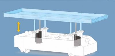

Connectivity is managed by onboard microprocessors and software in modern AGVs and to take the fullest advantage of the potential of digital communications, designers are also deploying smart actuators that have built-in intelligence as well. This enables integration with AGV automation schemes and communications among actuators themselves. The ability to synchronise actuators with each other, for example, could enable creation of an AGV lift table. Learn more at the link below:
