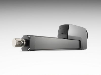

Thomson Industries, Inc., has announced availability of new synchronization capabilities for its Electrak HD heavy duty electromechanical linear actuators. Designers of equipment in which large or awkward loads must be moved repeatedly and evenly, such as large solar panels or heavy hoods on construction equipment, can now simultaneously distribute that load using up to four actuators.
Traditional methods for synchronizing multiple actuators can be inflexible. Gas spring technology, for example, is limited in application, while hydraulic cylinders can be prone to leakage and costly to maintain.  Non-integrated electronic systems have more flexibility and are cleaner but require external devices such as encoders and potentiometers to track position and send feedback to an external PLC or other logic solver.
“The ability to synchronize movement of large and potentially awkward loads is something our customers have been requesting as they seek to automate larger applications or improve ergonomics,” said Chad Carlberg, product line manager for industrial actuators at Thomson. “We are pleased to announce that we have tapped into the advanced electronics capabilities of our popular Electrak HD heavy duty linear actuator technology to achieve synchronization more easily and cost effectively than is possible with any other available approach.”
Thomson achieves its synchronization by embedding all load handling technology into a single electromechanical actuator, which is then wired in sequence with up to three other similarly equipped actuators. Designers install these wherever linear movement is needed without the need for external assemblies. Once the actuators are installed, customers synchronize them instantly by wiring them together and operating a single unit with a simple switch. During operation, system electronics detect speed changes that indicate load imbalances, thereby eliminating bouncing or other effects of imbalance.
By using multiple actuators, synchronization increases system movement speed more efficiently. A larger load that might normally use a single, heavy load actuator, for example, could be moved faster by combining multiple, lower load actuators. Synchronization also retains all Electrak HD mechanical capabilities, including the handling of bidirectional loads of up to 10 kN (2250 lbf) with stroke lengths up to 1,000 mm (39 in) and accuracy of 1% of stroke from 100-1,000 mm. High-quality ball screw assemblies provide efficient current draw and support speed options up to 43.5 mm/sec (1.7 in/sec) (using the 1.7 kN [382 lbf] version).
