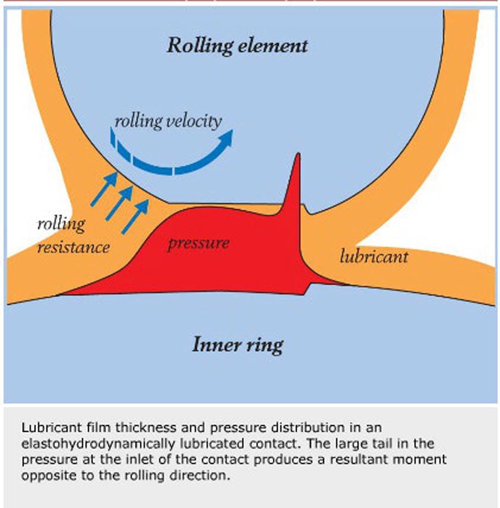

When we think about speed in terms of thermal limitations, the two primary drivers are load and lubrication. Lubrication is obvious, but perhaps not as obvious, are loads. Ball bearings can generate a lot of heat and become quite inefficient at high loads. It is a common notion that a ball bearing is always more efficient than a taper roller bearing. Intuitively, it makes sense. Tapers have a huge frictional sliding surface where the bottoms of the rollers and the rib meet. At first glance, it appears that a ball has almost no friction—a hardened steel ball on an equally hardened raceway. The difference comes in surface pressure and the losses come in the form of hysteresis (and a few other drivers); the small elastic yielding of the ball and raceway under load. Under heavy loads, it is no longer just near frictionless rolling on a hard surface. As loads increase, eventually the ball bearing losses will surpass tapers. Tapers are designed to take huge loads, spreading a load over the full length of the roller. As a result, hysteretic losses are much lower. Under continuous high loads, like you might find in some industrial applications, a roller bearing or sometimes even a larger ball bearing can be more efficient in terms of rolling losses. In automotive, we are always trying to find the right balance between highway efficiency and high load capability.
Now, please don’t go out and buy bulldozer bearings for your EDM design because Norm said they were more efficient—but you get the idea. There are tradeoffs with every design that must be calculated and not just assumed.
SKF has a nice, expanded explanation on loss mechanisms here:
evolution.skf.com/using-a-friction-model-as-an-engineering-tool-3/

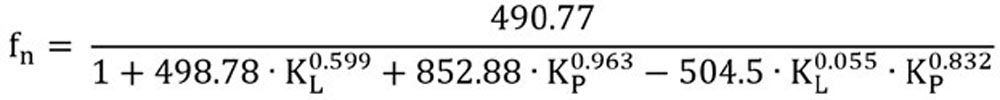

For the thermal speed rating nϑr, we will use the value that we calculated from ISO 15312 in our previous session. Recall nϑr for a standard 6205 is 13,300 rpm. Now we just have the speed ratio to deal with, which is still a bit of a handful. When the Lubricant Parameter KL is defined within the normal operating range of 0.01 ≦ KL ≦ 10 and likewise with the Load Parameter KP 0.01 ≦ KP ≦ 10; the speed ratio fn can be calculated as follows.

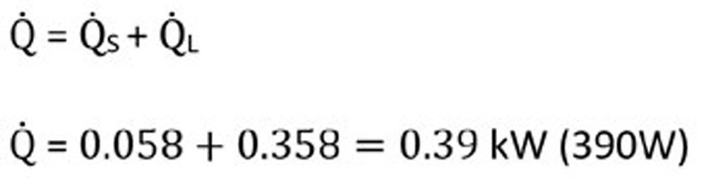

Let’s start by solving the total dissipated heat flow Q ̇:
Where:
In this case, the heat emitting bearing seating area, AS, is the same as Ar used in ISO 15312. Again using our 6205 example:
ΔϑA is the difference between operating temperature and ambient temperature. For ease of comparison, we will use the operating condition defined in ISO 15312 as 70°C. If we are operating at room temperature, ΔϑA = 47°C (23°C to 70°C).
Schaeffler provides the chart for the kq value. Below, the 1 line is for axial bearings and 2 is for radial bearings which includes the 6205 ball bearing. This gives us about 0.32 x 10-6. Our description states we should have a value between 0.2 – 1.0 x 10-6 which seems reasonable. There are a lot of unspecified factors here depending on architecture which is characterized by the large gray area. The faster the system can self-cool, the larger this value is.
Figure 2— https://medias.schaeffler.us/en/speeds
Therefore:
Now on to heat flow dissipated by the lubricant.
V ̇L is simply the oil flow. These numbers are always somewhat of a guess if you have a passive oil system. In these cases, you can just pick a reasonable middle of the road value ~ 0.25 l/min. There are published formulas that will give you estimates on needed oil flow rates based on speed, load and temperature.
Now we have;
Now we can solve the total dissipated flow rate. For this exercise, we will just set the external heating / cooling factor Q ̇E to zero. If you have a heater or cooler, you will add that value here.

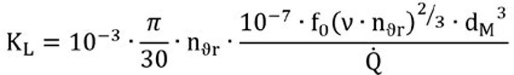

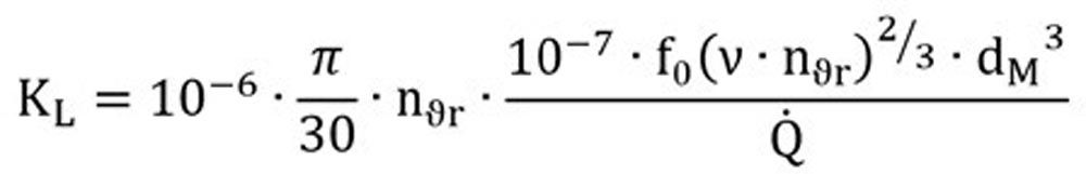

Now we move to the lubricant factor:
The bearing factor f0 is a table value that can be found in ISO 15312 and DIN 732 and referenced in public literature. In our case, the 6205 ball bearing has f0 = 2.0 (for oil bath or recirculation).
ν is the kinematic viscosity at operating temperature. For continuity, we will keep the value of 12 mm2/s as defined in ISO 15312. Recall that we defined our operating temperature at 73°C. Regardless of where you set your operating temperature, just make sure it is consistent. Again, we revisit our ISO 15312 results for the thermal speed rating nϑr: 13,300 rpm. dm is the mean bearing diameter (6205): (52+25)/2 = 38.5 mm

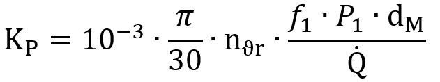

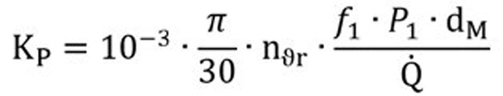

Now on to the load factor KP.
Most of these variables have now been defined—we just have f1, the other bearing factor and P1, the decisive load. f1 is as a simple formula in DIN 732: 0.0009∙(P0⁄C0)0.5 P0 is the applied equivalent static load and C0 is the static load rating. If axial loads are light, P0 can be estimated as the applied radial load. For the 6205 C0, we will use the SKF rating of 7.8kN. For P1 we will continue using the ISO 15312 parameter for ease of comparison – which was 5% of Cor (7.8kN) or 390N. Now we have f1=0.0009(0.39⁄7.8)0.5=0.0002.
Now we can solve KP.
It is coincidental that P1 and Q ̇ are the same value. Units are included for clarity.
*Schaeffler also provides a chart for basic configuration for reference. We can see here that for light load, the KP factor can easily run off the chart > 1. If we use the ISO 15312 value of 390N, this would give us a Co/P (7.9/.39) of 20. Something doesn’t seem to be lining up between the chart and the formula—the formula result seems too low. We will use our software to skip the guessing game, but for meantime, let’s use the old college trick of setting the variable to 1 as a placeholder.

Let us try solving fn with KL: 0.12 and Kp: 1.
This answer doesn’t seem terrible. We can do a little reverse engineering in Masta to see if our Kp assumption holds any water. Using all of the same operating assumptions from ISO 15312:
fn = 24,535/16,558 = 1.48
Working Schaeffler’s fn chart backwards, we see that the Kp value should have been around 0.69. I don’t have a quick answer on how to get that number from the formula. This may need some clarification with our ISO folks.
