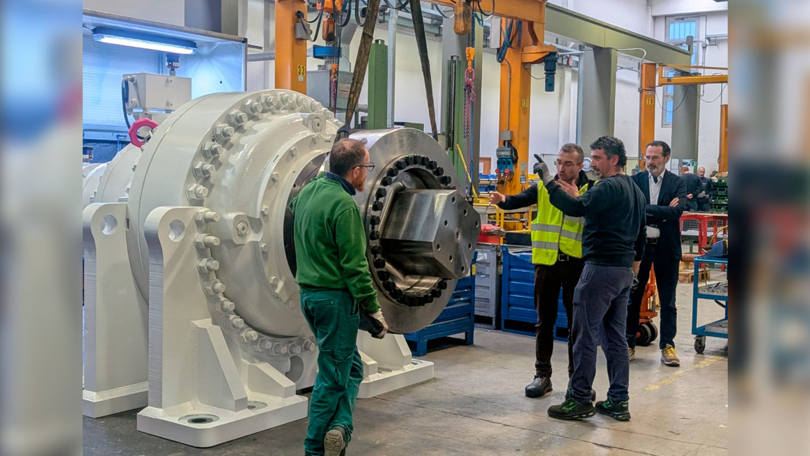

According to Fenner/MAV, the shrink disc pictured is the largest ever produced by MAV and is one of four shrink discs supplied to sugar mills.

Fenner Industrial Motion, through its MAV product line, worked with Rossi, a leader in industrial gearboxes, to provide a keyless locking device for the sugar mill’s power transmission system. Rossi’s gearboxes are used globally in every stage of sugar production, from cane preparation to crystallization. The solution was the MAV Shrink Disc 3009 560 mm x 940 mm Special, which created a rigid, frictional connection between the gearbox’s hollow shaft and the crusher rollers’ solid shaft, eliminating the need for traditional keys/couplings or mechanical fasteners.
The shrink disc is a mechanical assembly composed of conical rings and a set of screws. They provide a rigid, backlash-free, frictional keyless connection between an outer hollow shaft (hub) and an inner shaft. This is installed directly onto the hub which is then mounted onto the shaft. They allow the transmission of torque, bending, thrust loads, etc., either alone or in combination. They are suitable for shock and reversing loads. These components provide high contact pressure between the hub and shaft, offering high load capacity in combination with ease of installation and removal.

The solution had to handle a significant torque of 2,500 kNm, while keeping the overall system compact and minimizing stress on the components. The MAV-designed shrink disc met these strict requirements, improving both performance and cost-efficiency in the power transmission system.
