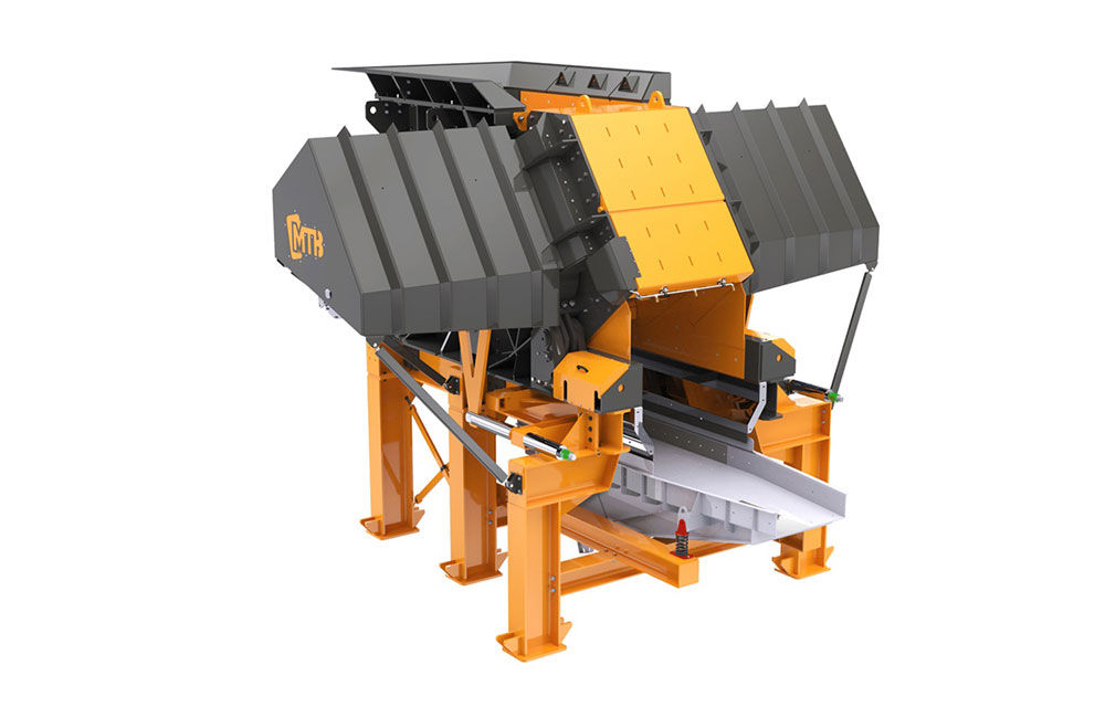

Wendt sold the MTB EZR Electric—a pre-shredding machine with an electric drive—to Rochester Iron and Metal, a recycling operation located in Rochester, Ind. The EZR Electric is the first U.S. electric pre-shredder, providing 92% drive efficiency thanks to its synchronous high-torque electric motors.  MTB machine designers turned to electric power over hydraulics, reducing energy consumption while developing a more circular economy.
Combining this with a mechanical design that allows the adjustment of output density and throughput of the machine after installation, MTB can tailor the EZR’s operation to meet specific customer needs at a lower energy cost.

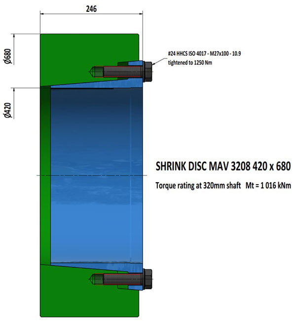

The shrink disc is a mechanical assembly composed of conical rings and a set of screws. They provide a rigid, backlash-free, frictional keyless connection between an outer hollow shaft (hub) and an inner shaft. This is installed directly onto the hub which is then mounted onto the shaft.
“Shrink discs allow the transmission of torque, bending, thrust loads, etc., either alone or in combination,” Zambanini said. “They are particularly suitable for shock and reversing loads. These components provide high contact pressure between the hub and shaft, offering high load capacity in combination with ease of installation and removal.”
MAV1.jpgThe shrink discs connect the gearbox’s hub to the rotor’s shaft, allowing MTB to use gearboxes with hollow, low-speed shafts.
The MAV 3208 shrink discs—used for this application—are mounted on the extraction and feeding rotors. They are extremely important in achieving the electrification of the unit. The shrink discs connect to the gearbox’s hub to the rotor’s shaft, allowing MTB to use gearboxes with hollow, low-speed shafts and a compact design, saving weight and space in the EZR Electric pre-shredder.
Zambanini said that the two-part design of the MAV 3208 is less conditioned by installation accuracy than the three-parts design shrink disc, since the single outer ring is guided during tightening operations by the long shallow taper of the inner ring, leading to extremely low runout error.
“Wear and fretting corrosion in the parts or in other locking elements (typ. keyed and splined connections) are eliminated, due to high contact pressure and absence of play (backlash-free).
Clearance fit mounting makes installation and removal much easier than in case of interference-fit or keyed connections,” Zambanini added.
In addition, the high contact pressure between the parts creates a stronger connection and a longer useful lifetime, especially in applications, like shredders, with shock or reversing loads.

MAV2.jpgDiagram of the MAV 3208 series shrink disc.
MAV locking assemblies use tapers that generate high radial forces when pushed together, creating high contact pressure and a zero-backlash connection. The locking assemblies mount gears, pulleys, cams, levers, rotors, and similar devices onto shafts, while the rigid couplings connect two shafts.  These products are adjustable both radially and axially, allowing machine designers and users to achieve perfect timing, making installation and removal easier.

The addition of the MTB EZR Electric pre-shredder will make the Rochester facility a safer, more efficient operation. In effect, the pre-shredder prepares the waste stream for the company’s large Wendt M6090 shredding machine. The pre-shredder uses low-speed, high-torque technology to allow Rochester to increase the throughput and cut the wear on its primary shredder. It also removes unshreddable material, greatly reducing the chance of catastrophic failure at the mill.
