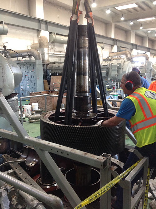

When the Atlanta Gear Works team brought the gearboxes back to the shop and opened them up, they discovered the repairs would be more involved than expected. And though the gearboxes were identical, the repairs would be different for each one, with a focus on the gears themselves.
Disassembly and removal of one of the gearboxes.
For the first gearbox, the team made all new gears, plus a spare set. In addition to the original specs, they identified that the thrust bearing and backstop needed to be refurbished and the lubrication pumps and coupling disc packs needed to be replaced.
For the second gearbox, they were able to use gears provided by Huxtable. Since the intermediate pinion shaft had sheared and greatly damaged the gears, to prevent future failures, they made a modification on the gears on that shaft at the point where it broke to reduce stress concentration. They also refurbished the thrust bearings and the backstops to prevent the gearbox from running in both directions.
