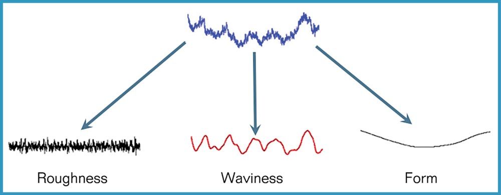

Figure 1—Surface texture consists of roughness (left), but also waviness (center) and form error (right).

Surface Texture Consists of Roughness, Waviness, and Form
As measurement equipment and software have advanced, the technology has shaped our understanding of surface texture. Rather than thinking of a surface as having a generalized “roughness,” we can more properly describe surface texture as a range of features of varying sizes. We describe the size of these features in terms of “wavelengths,” from short-wavelength roughness to longer-wavelength “waviness” and “form error.”
