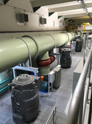

Installing the new equipment required further creativity. Each Sulzer SMD 1000 - 1030 weighs 18 tons (16.3 tonnes), and the pumps, motors as well as stands all had to enter the Oak Street building through a 10.5 ft (3.2 m) square doorway. Inside, structural concrete beams made it impossible to use a conventional motor stand design.
Sulzer engineers in Switzerland created a special motor stand for the project, which had to fit the original footprint, withstand the stresses imposed by the motor, and be dismantled and reassembled inside the building. The installation team also prepared for the possibility of dismantling the pumps for installation, but ultimately were able to maneuver the machines through the doorway using two cranes, with only half an inch of room to spare.
With work on the Oak Street pump station now largely complete, the new Sulzer pumps have been tested in situ and are ready for the official start to operation. The new units are expected to provide much-needed reliability improvements for a vital part of the New Orleans water infrastructure, and thanks to modern VFD technology, they will provide the SWBNO with useful energy savings too.
