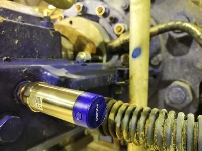

Sulzer, in collaboration with Finnish technology leaders, has designed a wireless IoT condition monitoring solution, Sulzer Sense, that targets these users’ needs.
The solution includes wireless sensors that can be attached to a pump, agitator, motor or any rotating equipment. The sensors measure temperature and vibration and send the data to the cloud. This means that the operating status of the equipment can be remotely monitored 24 hours a day, seven days a week through Sulzer’s online service. No onerous manual measurement is needed.
