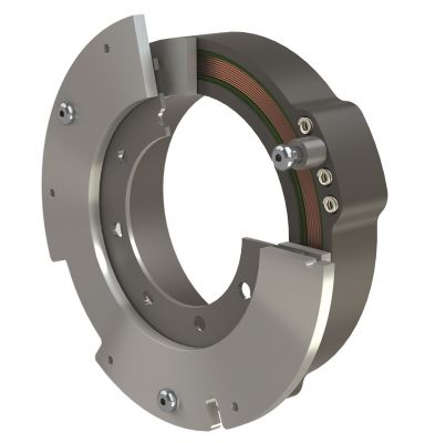

The ROBA-servostop series is ideal for installation into servomotors. A special hollow shaft design in slim constructional design and of a low weight has been especially tailored to requirements in robotic applications. In addition, the company has a fluid-free linear brake in its portfolio with its ROBA-linearstop in electromagnetic design, which has been designed to secure gravity-loaded vertical axes. This brake type is used in applications in which compressors or units for compressed air or oil hydraulics are not available or are unwanted - such as in the field of medical technology or the food or pharmaceutical industry, where high hygiene standards are required.
