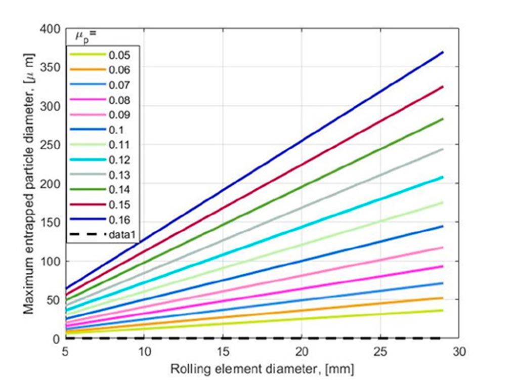

For a solid particle to be damaging in a bearing contact, it must be entrapped and it must be big enough to create an indentation. The hardness of the particle also plays a role, hard-brittle particles will chatter and will create very tiny but sharp indentations, softer particles (metals and fibers) will create indentations with rise material around (shoulders), see Figure 2. However, fiber particles in general will produce very shallow indents (basically negligible). The process of indentation has to do with the material of the particle and the material of the raceway, the harder the particle the smaller but the sharper and deeper the indentation becomes. The harder the raceway the shallower the indent that will be created. There are many works in literature that show indentation mechanisms from particles. However, entrapment and indentation together have been studied in the past by SKF. In Ref. 1 a simple entrapment model is derived for assumed spherical particles, but it can be generalized to any geometry because the relevant geometrical aspect is the local radius of curvature of the particle. With this model the plot of Figure 3 has been obtained, where the maximum diameter of the particle that can be entrapped is given as a function of the rolling bearing diameter and the coefficient of friction between the rolling bearings walls (raceway) and the particle.
Figure 3—Maximum entrapment particle diameter for different rolling element diameters and different particle-bearing friction coefficients.
It is reported in Ref. 1 that laboratory experiments were carried out where friction coefficients of μp = 0.1 were measured. However, in Ref. 2 it is reported that a bigger range is seen in field applications (0.1 ≤μp ≤ 0.15).

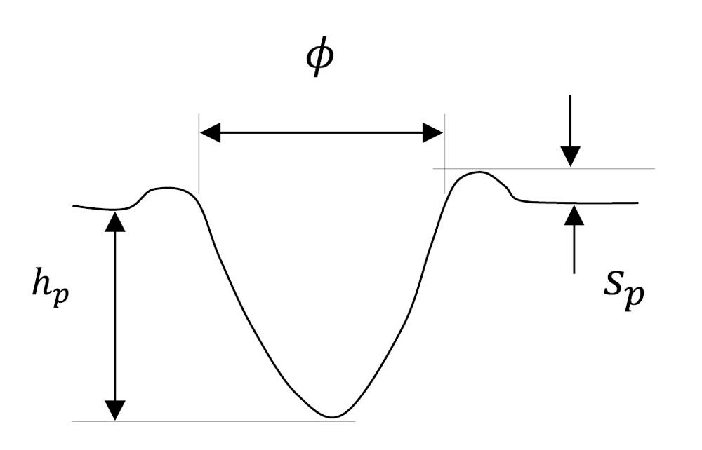

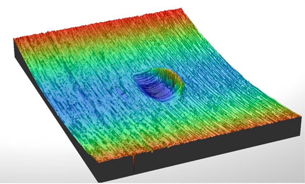

Ref. 1 also describes an indentation model, based on the geometry of the deformed particle. The indentation can be characterized by a simple indentation profile as described in Figure 4.
Figure 4—Schematics of the simplified geometry of an indentation profile.
Ref. 3 proposes a model that separates surface from subsurface survival, based on the SKF Generalized Bearing Life Model (GBLM) approach (Ref. 4) to estimate the damage induced by the indentations in bearings. This damage (represented by a damage integral) is a function of the contact pressure, the lubrication quality (k) in the bearing and the three geometrical aspects of the indentation described in Figure 4. A more general approach for damage calculation due to solid particle contamination in bearings is given in the ISO 281 standard (Ref. 5), with the estimation of the variable ηc also denoted as ec in this standard. Finally, Ref. 2 includes a diagnosis methodology based on bearing inspection to estimate the cleanliness level in the application for ISO 281 utilization.

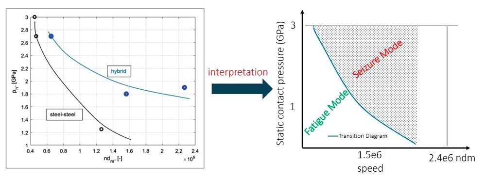

Figure 7—Transition diagrams from tested bearings for steel-steel and hybrid ceramic rolling bearings under standard (spindle) lubrication conditions and rings made of ASTM 52100 steel, inspired from Ref. 7. On the right-hand side plot the interpretation of the two potential damaging mechanisms.

Naturally, when speed or load is increased in this category of “performance series” bearings the risk to cross the damage mode limit from surface distress to seizure increases. Seizure damage manifests itself first as an enhancement of surface distress since the surface material can start losing hardness due to reheating, then discoloration can appear, see Figure 9, eventually the damage can be catastrophic.

For this platform, load and speed are high, the combination can reach the limits of Ph ≈ 3.0 GPa with ndm ≈ 3x106, tests with different steels for the rings and with hybrid ceramic bearings have been carried out successfully to show that even in conditions close to the above limit the bearings survive (Refs. 10, 11), see Figure 10.
Figure 10—Transition diagram comparison between the “performance series”, denoted as steel-steel and hybrid versus the “extreme platform,” here denoted as hybrid extreme, inspired from Ref. 11.
