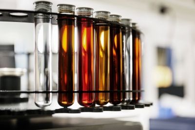

SKF RecondOil’s Double Separation Technology (DST) continually removes contamination, including nano-sized particles, from lubrication oil. This allows for a circular use of the oil, over a longer period of time.
“There is no comparable technology,” says Carl Philip Fredborg, team lead for deployment and aftersales, SKF RecondOil. “No other conventional mechanical filtering technology can remove nano-sized particles, which eventually cause oil to oxidize and degrade.”
