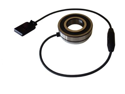

A newly introduced SKF sensor bearing equipped with an electromagnetic compatibility (EMC) filter offers protection against potential damage to the bearing’s sensitive electronics from power surges or electric discharges, most notably in AC electric motor applications.  The EMC filter is integrated in-line with the sensor bearing’s cable to protect the Hall sensor and other electronics used in the bearing and ultimately can help improve bearing reliability and service life.
The new sensor bearing with EMC filter provides a variety of monitoring capabilities for applications across many industries. Depending on application, SKF sensor bearings can measure a range of operating conditions, such as speed, position, and direction of a shaft, among others.
All SKF sensor bearings serve as ready-to-mount, plug-and-play units incorporating a shielded sensor and deep groove ball bearing. The sensor body, impulse ring and bearing are mechanically attached to each other to form a unit retaining tight tolerances within the bearing.
SKF sensor bearings can deliver benefits before and after installation.  Their design helps reduce development times and costs associated with manufacturing and assembly; a reduced footprint for the all-in-one units can allow for downsizing and weight reductions; and durable components and materials promote sensor bearing unit performance over time.
