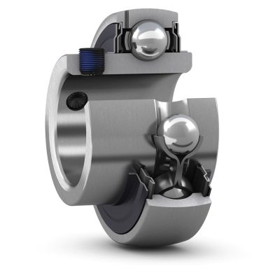

The new UC 300 ball bearing units from SKF are interchangeable with all JIS (Japanese Industrial Standards) housings. The introduction of the new products extends SKF’s UC range of ball bearing units, offering a comprehensive choice of reliable bearings that are available with short lead times.
The new UC 300 is ideal for use in highly contaminated industrial environments, where bearing life can often be shortened through the ingress of process materials such as mud, dust, wood chips or water.  To overcome these problems, the UC 300 series is equipped with field-proven sealing technology. It also has a solid base design of housing to minimize areas that might otherwise trap dirt or moisture.
When bearings are subject to systemic vibration, the results can include increased shaft imbalance, misalignment and loosening of locking mechanisms. The UC 300 series addresses these problems with its robust construction and high strength locking system. Designed to cope with operations characterized by higher peak loads and lower rotation speeds, each unit also features a grub screw locking system set at an angle of 62°, which gives even better holding power.
