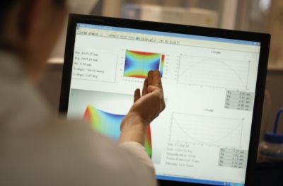

The newly introduced software calculation tools can help customers improve bearing arrangement design and select the most appropriate bearing for an application and conditions. These proprietary bearing simulation software programs – SimPro Quick and SimPro Expert – account for shaft, housing, bearings, external forces, and gear loads in calculations to arrive at the ideal bearing for the job.
