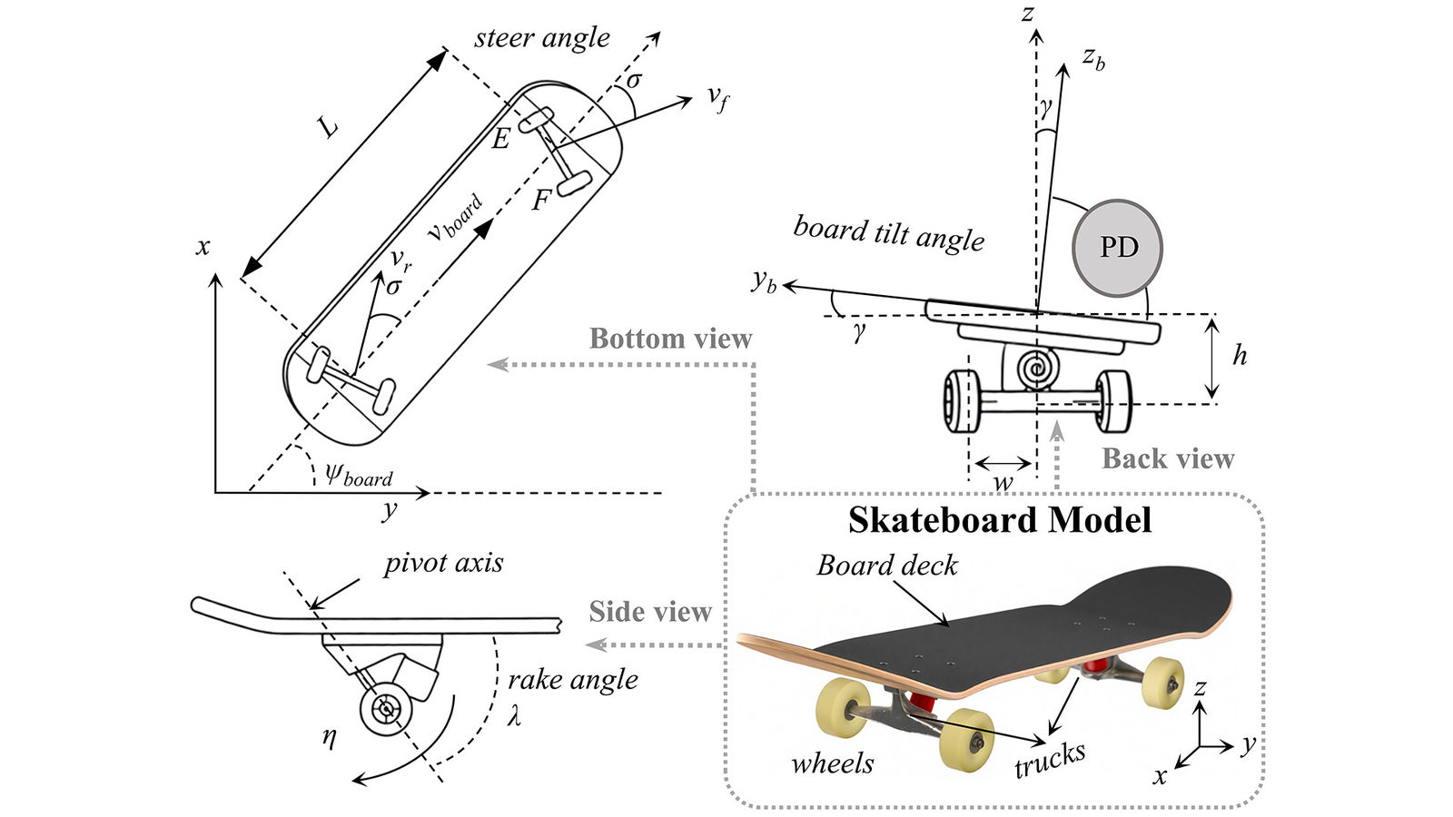

Skateboard kinematic model showing the coupling between deck tilt and truck steering. (Image: HUSKY Project)

Consider what happens when a skateboarder turns. The rider shifts weight, tilting the deck. The tilt loads the polyurethane bushings in the truck, which deform progressively and allow the hanger to pivot around the kingpin. The pivot-axis geometry converts that tilt into a coordinated rotation of the axle. The wheels change heading. At no point does anyone command anything. The rider’s body is the actuator, the bushing is the compliant element, and the ground reaction at the contact patch is the output—a chain of physics that only responds to forces.
The HUSKY team formalized this as a coupling equation mapping tilt angle to steering angle through the pivot-axis geometry—the foundation of the robot’s control strategy. Electric motors driving through reduction gearboxes at the hips, knees, and ankles produce coordinated torques that must travel that same passive chain—rigid links to feet to deck to bushings to contact patches—before anything turns. Every link is a power transmission element. None of them take orders.
So what happens when your actuator and your output are separated by a compliant interface you don’t control? The robot cannot stiffen the bushings mid-ride. It cannot change the kingpin angle. It can only generate torque and send it down the chain, trusting physics to deliver. The team characterized each board’s compliance by tilting the deck, releasing it, and measuring the free-decay oscillation to extract torsional stiffness and damping—classical vibration analysis applied to a skateboard truck. Get the model wrong and the results are concrete: apply the compliant board’s parameters to the stiff board, and the robot cannot even mount, because the real deck refuses to tilt under its step. Reverse the mismatch, and it over-leans and falls.
