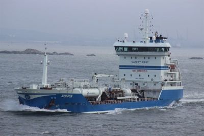

Sirius Shipping Invests in SKF Online Monitoring
With ten vessels in its fleet, Sirius Shipping transports liquid media such as oil and chemicals to ports in Northern Europe. Its destinations are mainly in Denmark, Norway, Finland and Sweden. Delivering shipments on time, safely and, not least, in an environmentally sustainable manner are important factors that customers demand. An unscheduled stoppage in the engine room causes costly delays. That is why well-implemented maintenance is so important to ensure deliveries are made on time.

In order to increase control of rotating equipment, the shipping company has chosen to install online status monitoring with measurement sensors for selected machine components. The Nimbus and Marinus vessels are the first to have this installed. Soon IMx-8 will also have been installed aboard the Neptunus and Scorpius vessels.
The choice of system fell on SKF’s IMx-8, the latest addition to the IMx range. This is a compact system that offers sophisticated functions taken from its bigger brothers, IMx-16 and IMx-32. The easy-to-assemble and compact system fits into Sirius Shipping’s maintenance system. Sensors detect machine parts and transmit signals online to SKF’s certified Remote Diagnostic Center in Hamburg, where specialists report machinery deviations.
