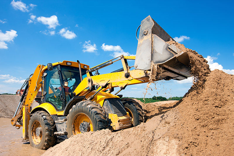

Wheel loading excavator unloading sand at a construction site (all photos courtesy of AST).

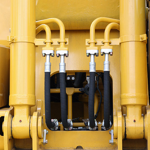

Hydraulic hoses of a modern tractor.

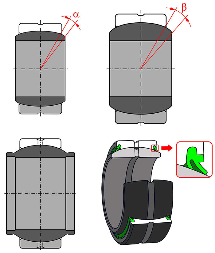

Spherical plain bearings are available in various types and configurations to address specific loading and operating conditions, and environmental conditions.
Spherical plain bearing configurations (Upper Left: Standard, with misalignment Angle α; Upper Right: With higher misalignment Angle β; Lower Left: Extended inner ring; Lower Right: Seal type).
Sealed Type
Spherical plain bearings are available with seals to protect the sliding surfaces in severe environments. The seals are affixed to the outer ring and make positive contact with the inner ring keeping dirt and debris out, and the lubricant in. Variations in seal materials and design vary from manufacturer, but most seals are either a polyester elastomer material or a buna nitrile rubber bonded to a sheet steel insert. These plastic and rubber seals are best suited for applications where the bearings see frequent tilting or circumferential movement. This tends to keep the contact surfaces clean.
Extended Inner Ring
To ease assembly, and eliminate the need for spacers, these bearings are also available with an extended inner ring design. These have a slightly higher cost.
High Angle
Depending on their size, most spherical plain bearings accommodate misalignment in the 5 to 15 degree range. However, higher angles of misalignment can be accommodated with a special series. This series has an increased cross section inner ring which allows for the higher angle of tilt, up to 20 degrees.

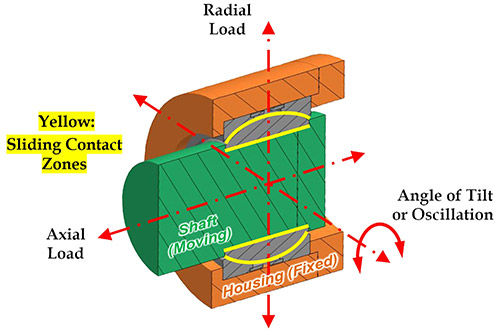

Cross sectional view of spherical plain bearing installed with shaft and housing. Radial and axial load axes, sliding contact zones.

Spherical plain bearings can accommodate loads in both the axial and radial directions, with the load predominantly radial for the latter. Angular contact types are available for heavier thrust or axial loading. Loads can be in combination, and the direction constant or alternating.
