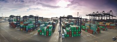

Over 70 percent of all break-bulk cargo (piece goods) in the world is transported by ship, train, or truck in ISO containers (standardized large-volume containers). Cutting-edge container terminals are therefore essential to ensure goods are handled efficiently. A well-known provider of these solutions is relying on a high degree of automation and Siemens communication and network technology when building a new container port terminal. A total of 42 cranes are controlled and automated using the largely redundant, reliable network. The pre-configured and tested devices were commissioned in successive stages. By ensuring the automation and PC systems were completely separated, the network retains a high level of availability, thus making a significant contribution to the efficiency of the container terminal.
Gantry cranes are the logistical backbone of every container terminal – they must run reliably for a long time, and communicate with the warehouse management system quickly and securely. The reliability of a crane network is largely dependent on being able to transmit transport orders quickly, smoothly, and tamper-proof to the respective crane. When building a new container port terminal, the client therefore relies on Siemens crane, automation, and network technology. The final expansion stage of the plant will have 42 fully automated stacking cranes interacting across three storage segments, each with seven storage blocks. Two cranes service each storage block. Manned straddle carriers which transport the containers connect the cranes and the storage blocks. Siemens RFID (Radio Frequency IDentification) technology is used to track the containers.
